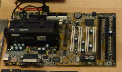

I am just building a Pentium II machine with a MSI MS-6119 board (with Award BIOS) and I need to update the bios (cause of some flaws).
There are two different types of bios:
a) for mainboard with "CPU PLUG AND PLAY"
b) for "MSI Standard M/B"
... see: https://us.msi.com/Motherboard/support/MS6119
The board is labeled "MS6119 Ver. 1.1 BX2"
How can I identify the correct type of the board?

Does it have jumpers/dipswitches? I think I see them on this image, if so then it's not "CPU PLUG AND PLAY", so use the standard one.
Also, it has a nice socketed BIOS ROM, so even if you mis-flash, it's easy enough to fix.

My MS6119 rev 1.1 is a CPU PnP one, and it hasn't got the FSB/multi dipswitch between the AGP and IDE ports in the picture. So yes, hopefully that could be used to differentiate them. Remember reading something about 1.x boards being standard ones and 2.x ones being CPU PnP when trying to identify mine, but that's obviously not correct.
Might be worth adding that I had some problems with the AWDFlash version that came with the image when flashing the p2.9 BIOS. Had to fall back on AWDFlash 7.70 to get it done.

Yes it should be the "CPU PLUG AND PLAY" version.
And thanks for the tip about AWDflash to kaputnik - I will try to update the bios.

The CPUs are multiplier locked. The only difference with the PnP model is you can change the FSB in bios rather than with DIP switches.
I have the PnP model. If you flash it with the non-PnP bios (as I think I did originally) you just don't get FSB settings in the bios so could only adjust eg with SoftFSB

I was feeling adventurous and installed the plug and play only bios on my seemingly non plug&play version ms6119. It actually worked... I could now set the fsb in bios. Tried 4x66 and it reads accordingly when I reboot. Maybe something wierd would happen if I actually put in a multiple unlocked CPU though.
Thing is however, that the latest bios for the plug and play version can't recognize hdds over 65 gig. It locked up during boot. I ended up removing the hdd and reinstall the latest non plug and play bios again.
