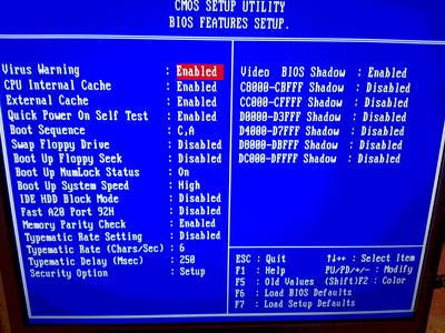

Reply 15 of 29, by Wilius

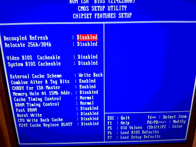

Reply 16 of 29, by Wilius
Here is the second picture.
Reply 17 of 29, by Deunan
Wilius wrote on 2020-01-31, 18:59:
I hope you can see the pictures. I wasn't sure which file licence I should pick.
Fifth entry from the bottom, says "Memory parity check" - set it to Disable.
