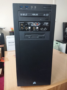

Hello all
been working on this since mid/late October 2019 to to put together and tweak to be as perfect as i can see it and seems a good build for cover the 2000's more or less
specs below -

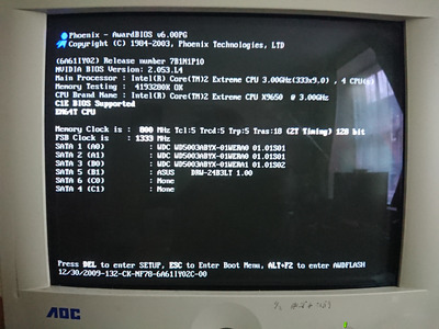

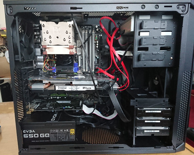

Motherboard - Evga nForce 780i SLI - 132-CK-NF78-A1
PSU - EVGA 650 GQ 80+ Gold 650W
Processor - Intel Core 2 Extreme QX9650 @ 3.00 Ghz (Noctua NH-U9S Heatsink with NM-i3 Mounting Kit)
Ram - 4 GB DDR2 (4x CM2X1024-6400C5DHX) (upgraded to 8GB DDR2 (4x Corsair twin 2x 4096-6400C5DHX))
Graphic card - Nvidia GeForce GTX 580 KFA2 Accelero Xtreme Plus 1536MB
Sound Card - Sound Blaster X-FI Fatal1ty FPS

- 3.5 Floppy (720kb - 1.44mb)
- Asus DRW-24B3LT - DVD/RW 24X
- 3x Western Digital WD5003ABYX - 7.2K SATA - 500GB (Added another HDD (4x Western Digital WD5003ABYX - 7.2K SATA - 500GB))
I/O Ports
- 8x USB ports (6 on Mobo and 2 on Case Using USB 3.0 to USB 2.0 Adpater)
- 1x Firewire Port
- 2x PS/2 Port
- 1x DB-9 M Serial
- Dual Ethernet Ports
-On-Board Audio (audio cable to line in on sound card to use headphone jack on case)
Extras
- Sound Blaster X-FI Fatal1ty FPS - 5.25 I/O Bay
- 3x 120mm Case Fan
- 1x 140mm Case Fan
- PS/2 Mouse + Keyboard
- Corsair Carbide Series 200R Case

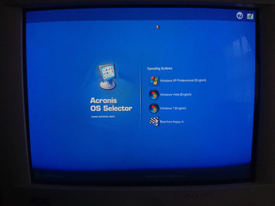

Operating Systems
- Windows XP Professional SP3 ------->------->------> All Using Third
- Windows Vista Ultimate SP2 x64---->------>-------> Party Boot Manager:
- Windows 7 Ultimate SP1 X64------->---->------> -->Acronis OS Selector 11

Reply 1 of 6, by chinny22
Very Nice but maybe thats becoause it's very close to my daily PC!
M/B: Asus P5N-D (750 SLI)
CPU: Xeon x3320 2.50Ghz with Noctua NH-U14S heatsink
RAM: 2x Crucial Ballistix Tracer 800MHz 4-4-4 (I like flashy lights)
GPU: 2x ASUS GeForce GTX590
Sound: SB X-Fi Titanium Fatal1ty Champion (Also with the drive bay)
FDD: Gotex
Case: Corsair Obsidian 650d
HDD's and DVD whatever I salvage from work much like how I got the CPU.
It's built to be a WinXP powerhouse which it is. Win7 is just used for web surfing basic office task which it's fine at.
775 is a funny era. Even though it came out end of XP era it outlasted Vista and made it into Win7 PC's
Someone no doubt will say what's the point of having Vista installed, and yeh it is pointless but it isnt a bad OS to have a poke around with these days.
Reply 2 of 6, by Robhalfordfan
thank you - took a while and thinking one of two things to add but deffo at a much more later time 😀
it is not as powerful as my daily modern win 10 machine for stuff generally early 2010s to present - ish
win xp is deffo a powerhouse for this build and the high end
vista is there because why not 🤷 (for few vista dx 10 games and vista only stuff - which i know there is not that many ) and for high/mid end
win 7 is there for stuff that dosen't run in xp at all and doesn't run well in vista which is more mid/low end
