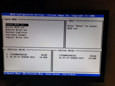

I have bought a PCI Sata controller. It's a silicon 3114 from Delock.
It recognises both the SSD and the DVD burner in the silicon 3114 bios, but I still can't use the DVD burner afterwards. What can I do to make it work?
The DVD burner does work when I install a direct IDE to SATA converter, but when I use a pci controller, it doesn't.

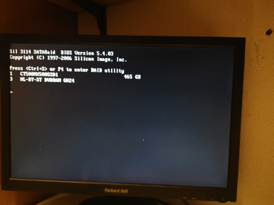

Reply 6 of 20, by Tiemen
The BIOS
So it recognizes both, but only the ssd works afterwards.
And I don't know how to flash the BIOS to be honest. Would that help? Because it recognises the ssd, so the DVD should also work right?

Reply 8 of 20, by matze79
Looks like you have the RAID BIOS installed

Reply 10 of 20, by Doornkaat
Ok, dude. As matze79 already said you have the RAID BIOS installed and it may well be the root of your problems.
Attatched are the flash tool with description and what I believe to be the non-RAID-BIOS. Flash that and see if it works.

Reply 13 of 20, by Tiemen
Guys, thanks a lot for all your help 🙂
I tried to update the BIOS, but I didn't succeed.
It isn't necessary anymore. I tried reinstalling windows 98, and I got a data error. With Cyclone3d's message in my head I thought to myself that this isn't worth it.
