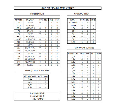

Hi, i am building a SS7 retro mini-PC using the Asus P5A-B v1.03, and I took some time to take all the undocumented jumpers settings this motherboard has, i have not seen them published, so i hope you don't mind me to share them with you. They are for P5A and P5A-B
Wow, it is amazing this motherboard allows 150 Mhz, i think i have never seen a SS7 motherboard allowing that much FSB speed.
Cheers!

I doubt it's possible to achieve 120+ reliably, at least on most motherboard. Some lucky board might have lucky chipset though.
