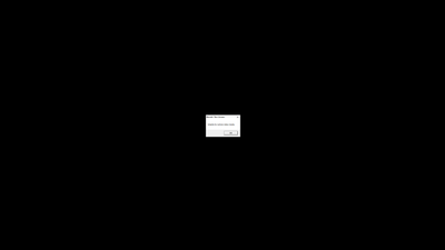

I'm having a hard time getting Blood II (GOG version) to run on Windows 10 Home. I've installed the Resolution fix, the widescreen patches and dgVoodoo 2.63.1 and all I get when I launch the game is a small black window in the middle of my Desktop and the game audio (Intro movies, main menu).
I know that I was able to run the game fine with these patches and 2.63.1 on Windows 7 but since I switched to Windows 10 this doesn't seem to work anymore. I don't have any problems running Shogo - Mobile Armor Division with 2.63.1 on my Windows 10 btw. That game runs absolutely fine. Does anyone have any ideas what I could try to make Blood II work again?

I can make the game run with this https://github.com/elishacloud/dxwrapper/wiki … d-II-The-Chosen + the high framerate fix and the widescreen patch(es). But using this DXWrapper will make the game only run in 16 bit color mode and also the framerate can't be locked which causes glitches during cutscenes. I can lock the fps with something like Bandicam but then sometimes I get fps like 40-30 in some areas for whatever reason. That shouldn't be a thing with my i7 and GTX 1060.
dgVoodoo was definitely the best way to run this game on a modern system and I would really love to use it with the game again. I don't know why it does work with Shogo and not with Blood II. I tried the current version and also older versions but none of them worked with Blood II. It's frustrating.

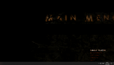

EDIT: I installed 2.63.1 again, configured everything like it was said on PCGamingWiki and now when I hit Alt+Tab I can see the intro videos and the main menu. The only problem now is that the game is not fully shown. I can only see the top left corner of the game for some reason. If I use Alt+Tab more than once the game will crash (see attached screenshots).

Reply 3 of 13, by ZellSF
Have you tried copying dgvoodoo.conf from the archive to the game directory? It's possible you have a problematic configuration file (in case you've run dgVoodooCpl.exe, it's possible it's not altering the right conf file).

I tried a few more things and at the moment I'm able to play the game again. I had to check the "Center App window" box in dgVoodoo. Now when I start the game and hit Alt+Tab the whole game window is visible again. The only weird thing that remains is that the game always starts in a small black window and will only be visible when I hit Alt+Tab. It's like the game starts always minimized or something. No idea why that is happening.

Reply 8 of 13, by ZellSF
It's the compatibility mode GOG installs apparently (ForceSimpleWindow). Go to add/remove programs and uninstall the entry "GOG.com Blood 2".

Installed the offline installer version of Blood II but I still don't see a "GOG.com Blood 2" entry anywhere. The one I can see is "Blood II - The Chosen" but that's all.
EDIT: Ok I found and deinstalled "GOG.com Blood 2". The game does start normally now. No Alt+Tab or Alt+Enter needed to make it go full screen. Finally I can play it again.
