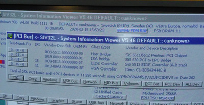

What is the PCI Device ID of your card? I suspect you may need to add a couple more lines to the [Mfg] section, I suspect:
%PCI\VEN_1013&DEV_00A8.DeviceDesc%=Driver.Install, PCI\VEN_1013&DEV_00A8
%PCI\VEN_1013&DEV_00AC.DeviceDesc%=Driver.Install, PCI\VEN_1013&DEV_00AC
Reply 5 of 18, by kixs

Reply 7 of 18, by red-ray
najls wrote on 2020-02-15, 11:09:
red-ray wrote on 2020-02-15, 08:56:
I don't know 😒 How can I find out?
There are several ways, one is to run my SIV utility (See SIV support for 386/486/586 class + Alpha CPUs and 3dfx + S3 + SiS + Matrox + XGI + old ATI + NVidia GPUs - Testing Help, grab SIV32L.zip) and press the [ PCI Bus ] button, doing this should display all the PCI devices. On this system I get:

Reply 8 of 18, by najls

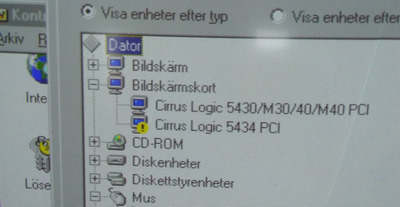

Ok, cool! You were right in that not everything seems to be in order (yet). On closer inspection I found that Windows doesn't properly recognize the card (see first attachment).
Anyway, I used your software and if I understand this correctly the ID should be 1013-00A8-00000000-8E (second attachment). But how do I use this in the .INF file? This is way above my head btw, if that wasn't obvious 😀

Reply 9 of 18, by Horun
Can you remove the driver and delete the 5440.inf then use the attached .inf and reinstall the driver please ?
    5430_34_40.zip

Reply 10 of 18, by red-ray
najls wrote on 2020-02-15, 15:08:
I see Horun has updated the .INF for your GPU. I compared before with after and the additions look correct to me.
Fingers crossed that it now runs OK
Reply 11 of 18, by Horun
red-ray wrote on 2020-02-15, 16:30:
Thanks but I missed editing a copy line, think it would have errored. Updated the file.

I'm back! Tried the updated .INF and it seems to work just fine! Windows recognizes the correct model now and everything seems to be in order 😀
Thanks so much to both of you for spending time helping me out. And hopefully this will be helpful to someone else as well!
