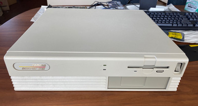

Backstory - this is my most precious computer. I bought it myself, new, with two or three saved summers' worth of mowing lawns in the neighborhood. It was sold at dealers back then, so it must have been a strange sight for a ~14 year old to show up to buy it! It's a 486DX2, ISA slots, and I even have the 64kb cache card. It got me through most of high school and a year of undergrad before I jumped to a P3/450. It's been largely powered off ever since.
Two weeks ago I began to painstakingly restore every last bit of it - aesthetic & functional. The GREAT news is that until two days ago, after a lot of cleaning, troubleshooting etc. it was running 100%! When I first powered it on, I was kind of shocked that the battery appeared to have survived the test of time--clock had only drifted a couple of days. Configuration at time of last successful boot: 16MB RAM (untouched), a SB16, the cache card, 3.5" FDD and a 120MB Quantum Prodrive... all working and booting to a freshly installed DOS 6.22.
On the next boot, I heard the dreaded beeps and got a '162-System Options Not Set - (Run Setup)' message which I'm getting ever since. Going to setup, I'm prompted to re-specify my floppy drives, but a reboot doesn't clear the issue. The FDD no longer is recognized (nor does it do a power-on seek during POST) and sometimes the HD boots to DOS, other times I get a 'Missing Operating System' as though CMOS settings for the drive type have gotten screwed up. Is this the Dallas RTC/battery finally giving out? Could it be that it was running on fumes and the past two weeks' activity finally depleted it? Or is that a red herring and I should look elsewhere?

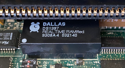

The chip is a Dallas DS1397 chip ("REALTIME RAMified" on the housing... haha).

The Dallas DS1397 chip
I'm not great with electronics work but I can do some rudimentary soldering, de-soldering and have a multimeter. I wanted to get advice on what to do next before I start trying more invasive things.

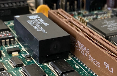

If I am not blind, your Dallas IS socketed.
So just replace it 😁
Reply 4 of 7, by Swiego
Is it?! That would be pleasant. It does look like it's on a pedestal which perhaps is the socket. Just use some tongs or other fixture to pull straight up? (Tried the finger wiggling test and it's solidly attached.)
Here are some better side views.

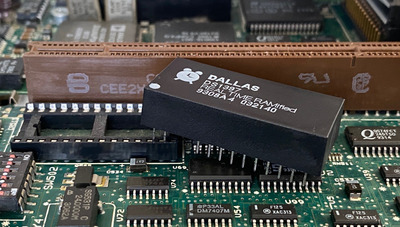

And update: yeah, that was rather easy to remove! Excellent thank you! Now to the next step of checking if the battery is dead.

PROBLEM SOLVED.
It was the floppy drive cable... not properly connected to the pins on the motherboard (offset one set of pins.)
Vynix - your comment helped - realizing the clock is not resetting and therefore the battery must be Ok, I went back to basics. When I reset configuration in F10 Setup, the BIOS asked me not only to identify the floppy drives but also some other things e.g. power-on Num Lock state. Whereas on a power cycle, it only asked me to verify the floppy drive configuration. This led me to think it was about that 3.5" drive. All fixed!
