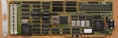

Just like to report I have (almost) my new TIGA running 😉
Re: Bought these (retro) hardware today
Its the same card mentioned here....:
Intel 82706 Graphic Card
Hercules Graphics Station TIGA
http://www.os2museum.com/wp/two-more-tigas/
It was not easy to find the drivers, therefore....:

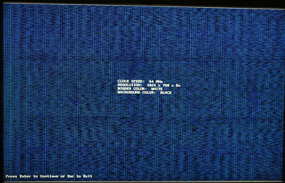

I think my card has 2 problems:
There seems to be a thermal problem with the RAMDAC? After powering on, text display is quite OK. After some minutes it looks like that and gets even worser....

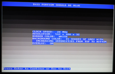

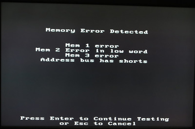

Then the Hercules test programs complains about a memory error. This seems to be related to the ZIP-RAM as the SIMMs are tested later without any error:
1.24 MiB
1182 views
Other screenshots:

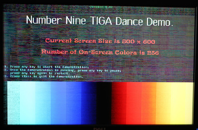

TIGA Demo:
1.53 MiB
1182 views
Reply 2 of 10, by pentiumspeed
wiki TMS34010 leads me to a page about that chip and list of arcade games and one of them is S.T.U.N. Runner which I was searching for long time and hopefully get one so I can play at home.
Get either canned air (invert the can and it will be a freeze spray), or freeze spray can. If either one is cheaper. Get the card act up by warming it up and selectively spray each chip till you find one that get better when colder or change in behavior.
This was consumer repair method to find bad chip back in the day.
Cheers,
Great Northern aka Canada.

VGA functionality is provided by Intel 82706, same as on the Hercules VGA card.
It seems Hercules was the only to use that chipset.

Reply 5 of 10, by Predator99
Ah OK, didnt know the TMS34010 was used in arcade games. But as far as I know there is no DOS game support this.
Dont think my card is repairable. I dont have replacement ZIP-RAMs and dont know which one is not working.

Like I suggeted, freeze one component at a time till you find bad one, Even heat from hair dryer trick do same thing as well.
