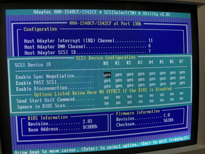

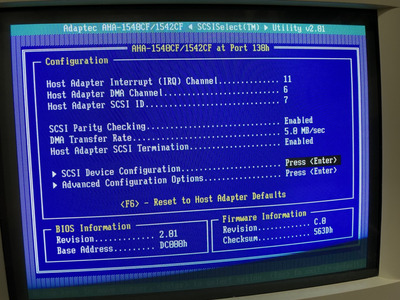

For better performance I bought a 1540CF card (without floppy connector) and SCSI2SD v5 for my 486DX2-66. I use a 32G SD card which contains 4 SCSI drives (2GB each) and they just work.

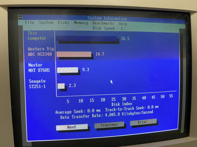

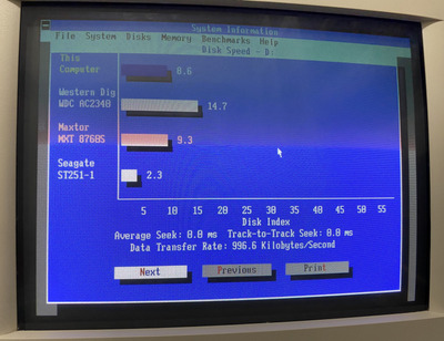

However, when I check disk performance from Norton Sysinfo 8, they only produce around 996 Kilobytes/s and that is far below the original 512MB IDE DOM which can produce around 4045 Kilobytes/s.
The card only has SCSI2SD connected to it and loading ASPI2DOS and ASPIDISK in config.sys didn't help .
What should I check and do to have better performance?

Reply 7 of 18, by Grzyb
Xeen wrote on 2020-02-27, 09:42:
It's a Gateway2000 486DX2-66v which DOM is directly connect to onboard IDE port.
So...
local bus IDE vs. ISA SCSI
Sorry, there's no way for SCSI to be the winner here.
1 MB/s indeed seems somewhat slow, but can't expect it to be faster than about 3 MB/s - Re: ISA Hard Drive controllers
Nie rzucim ziemi, skąd nasz root!

Reply 10 of 18, by Grzyb
I use SCSI2SD V5 and hopefully "1.1MB/s on most older SCSI hosts" is not my case. 🙁
I suspect that ISA SCSI hosts belong in the "older SCSI hosts" category here, so yes, that's exactly your case, everything is normal.
Replacing that Adaptec 1540CF with a VLB counterpart would surely help, but - as already mentioned by Doornkaat - it would still be slower than IDE.

Reply 12 of 18, by Xeen
Grzyb wrote on 2020-02-27, 11:49:
I believe it is the case, tried all card options including enabling BIOS shadowing and none of them can help.

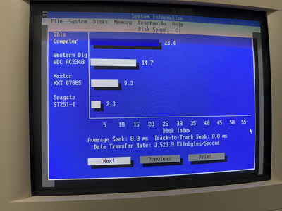

derSammler wrote on 2020-02-27, 12:00:
Note that SCSI does data transfer without the CPU. So even if it is slower from the data throughput in your case (blame the SCSI2SD v5, the V6 is the fast(er) one; also a SD card is way slower than a DOM!), it may still be faster overall, since the CPU has more free time to do stuff while data is loaded.
It's not difficult to see SCSI2SD is slower than a DOM especially when switching drives and do "dir/w", but it's a surprise that SD card is way slower than a DOM. 😮
I replace the DOM with a 2GB CF card and performance is as good as DOM.

Reply 16 of 18, by mpe
I have both SCSI2SD 5.0 and 6.0 and different controllers.
Without much tuning I and average card I could get:
SCSI2SD 5.0 with 1542CP about 1000 kB/s. This is a limit of the SCSI2SD 5.0 performance and async transfers.
