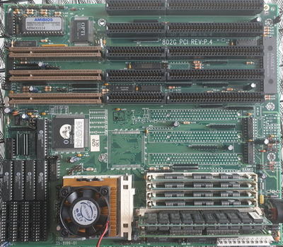

I have an unbranded Socket 3 motherboard I am unable to find anything about online. As I always like to check potential BIOS updates (bigger drives support usually) and just for curiosity's sake I'd be happy to know more about it, if possible!
Please see attached pictures. What I know and what we can see on the pics, typed out for convenience:

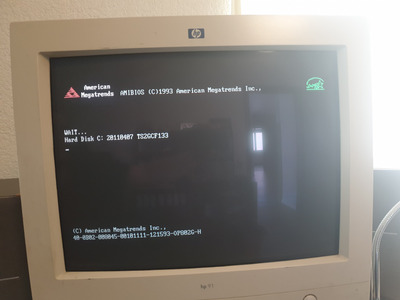

- It's an AMIBIOS chip from 93, only 14 pairs of pins, 2 pairs unused. Don't know if that's common but I don't think I've ever seen it before. Could it be a bastardized chip from another card?

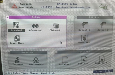

- BIOS menu itself is a graphical interface I've personally never seen before, and contains no identifying information whatsoever
- BIOS ID String : 40-0B02-008045-00101111-121593-OP802G-H. On Wim's BIOS page, 008045 manufacturer code doesn't exist, while 8045 could be "VTech", "PcPartner" or "Aristo"
- It's an OPTi True Green based MB, with chips 82C895 and 82C602
- Big "802G PCI REV:P.4" between ISA slots.

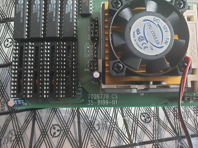

- "702677B CS" and "35-8199-01" near the CPU slot.
- AMI ID Utility (AMIMBID v1.4) reports "Unknown, please contact AMI Support", no information whatsoever.

Reply 1 of 11, by iulianv
Closest I could find is https://stason.org/TULARC/pc/motherboards/E/E … VL3-MP032F.html followed by https://stason.org/TULARC/pc/motherboards/B/B … 6-BEK-P402.html
Unfortunately BIOSes don't seem to be available for either of them, so I guess there's very little chance for one to be available for yours either...
Reply 4 of 11, by Deksor
I've found something here : http://www.elhvb.com/mboards/vtech/manuals/48 … /35-8199-01.ZIP
Its name seems to be "OPTI 486 VIP/VI"

I actually just want to add some detail about the missing parts of this board.
The big empty pad near the PCI slots is very likely the famed OPTi 82C822 VLB to PCI bridge chip.
111.69 KiB
845 views
161.44 KiB
845 views
So if you ever considering transforming it into it's full form, that's how you could go about it.
