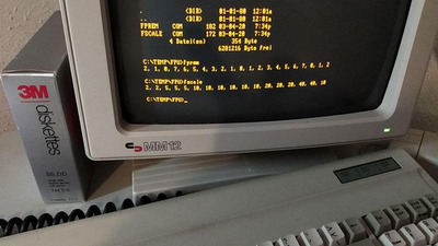

Reply 5 of 34, by matze79
Result:
104.81 KiB
445 views
GPL-2.0-or-later
CPU: NEC V20 @ 9.54Mhz
FPU: 8087 @ 9.54Mhz

Reply 7 of 34, by Deunan
Yeah, I know ZIP made a poor job of compressing these files but it's still a non-executable container that anybody can open. I don't want to attach the COM files directly, might upset browsers and/or OS trying to download those.
Anyway, many thanks for the tests. The issue that the docs mention (for 8087 as well) didn't manifest, weird. I assumed it was present in 8087 but fixed in 287, somehow I don't think Intel messed up two datasheets. But who knows.
Just in case I've prepared a revised testing package, there is now a second test called fprem2, and a simple detection program to test my code. matze79, when you have time, please run fprem2 on XT machine (and also detect while at it). Perhaps I interpreted the datasheet table wrong and I test too big numbers so this second test will try smaller ones. It should output something like 1, 0, (...), 0, 1

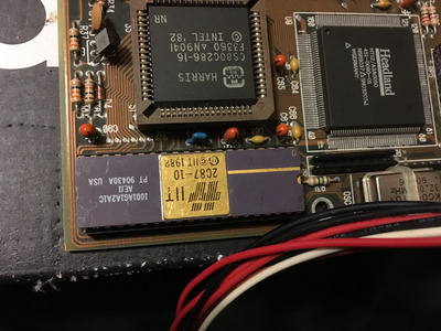

I have an IIT 2C87-10 (IIT version of 287) that I could test this weekend. I do not even know if it works so this would be a good test.
dionb wrote on 2020-03-04, 20:55:
I also have an Alaris Leopard with IBM 486SLC2 (i.e. a 386SX on some serious steroids) and some or other co-processor, I believe an IIT. Would you potentially want the results from that too?
Yeah IIT made a 387 mathco too. I have a copy of the diagnostic disk from IIT for their 287 and 387, will dig it out and post it to the library.
Added: mispelled and the II 2c87 mathco works ! will post results soon !
I got the same results as dionb and matze79 using a Headland HT12A board, Harris 286-16 and the IIT 2c87-10
