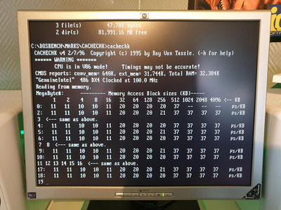

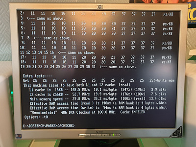

I have a retro machine that I have been playing with some. When I run CHKCACHE (have philscomputerlabs DOSBENCH stuff) it runs very very slow. I am not sure if its the RAM memory testing or what it might be - but it feels "wrong". What could be wrong? How do I know what settings to setup my RAM and cache correct
My settings and results are:

Reply 1 of 7, by GigAHerZ
chkcache always takes a lot of time, if you have a alot of memory... And 32MB is quite a measurable amount.
Reply 2 of 7, by mpe
The results are fine though. What I'd roughly expect from untuned average DX4-100. Your WB is disabled, but cachechk doesn't test hat.
You can use "-q" or "-qq" arguments to let it run faster with some impact on accuracy.

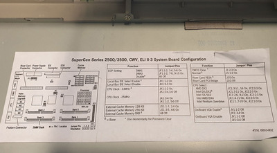

Reply 5 of 7, by claesbas
mpe wrote on 2020-03-05, 10:59:
In order to get WB working you primarily need to move a few jumpers on the motheboard.
In the chart inside the case (Unisys ELI 4663) there is some info about jumpers but nothing about Write-back. Not sure the mobo supports write-baack?

Reply 7 of 7, by mpe
claesbas wrote on 2020-03-05, 16:46:
There isn't anything indicating wb support on that schematics.
There are three of four extra CPU pins that need to be wired to chipset in order to support the WB and vast majority of motherboards with support have several jumpers for that.
If it is the same system as in this thread, then you'll probably find more information printed on the motherboard.
Look for settings for P24D and keep voltage at 3.3V as it is usually the closest unless there is a direct setting for DX4-WB or Am486DX4 Enhanced CPU.
