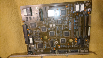

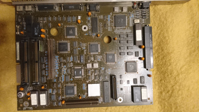

Looks like I did it again, I keep buying computers nobody ever heard about. I can't even find info about the mainboard!
It turns on so at least the enormous power supply works, ESDI drive spins up, but nothing shows on screen through the VGA output.
Plenty of big tantalum caps onboard, so I'll have to measure those first. No visible damage anywhere else but it has two battery backed chips:
A DS1225AD-170 SRAM and a DS1287 RTC. Could these cause this problem?

Reply 4 of 21, by Predator99
Looks interesting.
You should shift this to the "hardware"-section so more people can see it.
Also dont know where to start. Does it try to access the floppy after powerup? Is a speaker in the system and is there a output?

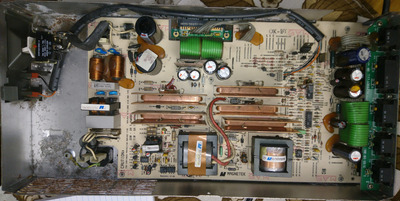

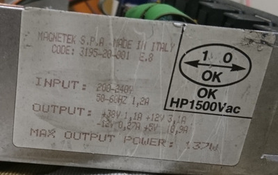

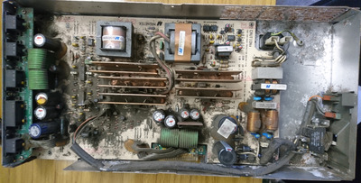

I finished cleaning and measuring the PSU. It was insanely dirty but no visible damage to the components.
I'm getting very strange readings though:
? means a value that is "jumping around" between 0-300mV.
- means a reading below 30mV that is holding steady.
I have +5Vs, +12Vs but missing the +38V and the -12V the PSU case mentions.
Faulty PSU?

Reply 18 of 21, by Miphee
Maybe the +38V is for the dot matrix printer that attaches through the back of the PSU. It has several ports there. Still missing the -12V rail.
Reply 19 of 21, by Miphee
Okay, so my progress so far:
Checked the PSU voltages on the MCA bus and everything is fine. I even found the +38V rail so the PSU seems OK.
Checked the RAM the POS came with: working fine. Tested the computer with different RAMs, no change.
The attached monitor demagnetizes when I turn the machine on so something must be sent through the VGA port. I use an IBM 8513 and this POS was shipped with this exact same model.

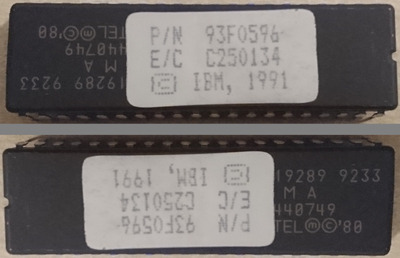

I made the Supersoft ROMs and they did nothing. No beeps, no signs of life. Are there any more "dual" BIOS ROMs I can try, maybe for the 386SX?
CPU gets slightly warm.
Don't know what the 93F1475 ROM does next to the Dallas SRAM. Maybe that SRAM losing battery power has something to do with it? Maybe it's the DS1287 RTC?
The 93F0596 is also unknown but since the rest of the ROMs were fine I considered that also OK.
So unless there is a hidden short somewhere my money is on the 1287 and the 1225.
