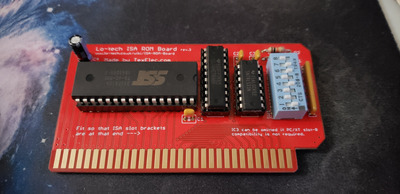

I'm trying to get XTIDE running on my 486 and having no luck getting the ROM to work.
I just assembled a Lo-tech ISA ROM board (the board with just the EEPROM on it) because my previous attempts to use a NIC had failed. However, no matter what address I set the card to, it never boots into XTIDE.
I flashed the EEPROM with my ROM burner and verified that it is correct. Following the bill of materials for this card, I am using a 1 megabit SST39SF010A EEPROM. I made sure to use the customized BIN file when flashing the chip.
When I use debug to view the memory location the ROM is supposed to occupy, I can't find it.
I understand that the default memory location is D000. I used the UMBInfo utility to view the contents of my memory but D000 doesn't even show as part of the memory map.
Is there something obvious I have overlooked?

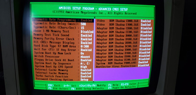

Reply 3 of 5, by konc
Disable all shadowing and give it another go, probably it's not this but just in case...
Reply 4 of 5, by matze79
Without shadowing for XTIDE ROM you will slow down your IO if its using BIOS Calls 😳
Did you configure the XTIDE ROM for right Controller Type and I/O ?
Does your 486 BIOS Support Option ROMs ? some non Standard Machines don`t.
What Machine is it ?

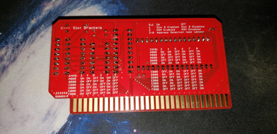

How did you flash the ROM ?
Can you make Photos of the Lotech Card with DIP Switch Settings ? front and backside ?

The machine I have is an OPTi 495SLC. It's pretty hard to find any documentation on it. The video card ROM shows up in System Information as a ROM BIOS extension. I'm guessing that might not be considered an option ROM.
I flashed the ROM with a TOP ROM burner. It's pretty reliable. I couldn't flash it in the 486 because the XTIDE flashing program doesn't support the SST39SF010A.
I used the auto configure option in XTIDECFG and its findings look correct.
It looks like shadowing is already disabled. Maybe I need to turn on shadowing for the XTIDE's address instead?
