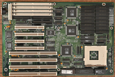

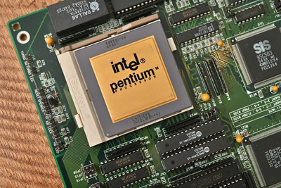

I thought I'll put my favourite parts together and build a Socket 4 system..
Briefly considered Batman's Revenge motherboard . However, my tuned ECS SI5PI which I recently upgraded to 2MB of L2 cache is probably even better option.
584.35 KiB

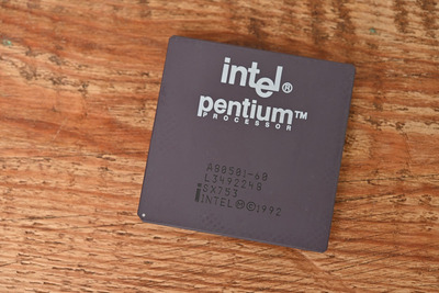

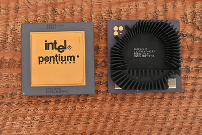

As for CPU. I'ld like to have two options. I'll start with SX837 P66 CPU -a classic choice with the original Pentium logo and even has the FDIV bug. However, I am keeping my SU082 Pentium Overdrive as alternative when I need the ultimate Socket 4 performance:
298.72 KiB
4064 views

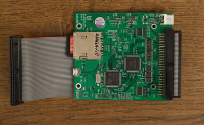

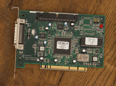

Given the motherboard integrates the infamous CMD640 IDE chip I thought I'd be happier with going SCSI as the main storage. Adaptec AHA-2940-S76 PCI card:
448.74 KiB
4064 views
Which will be maxed out by SD2SCSI v 6.0 with a fast SD card as the backing storage:
332.44 KiB
4064 views

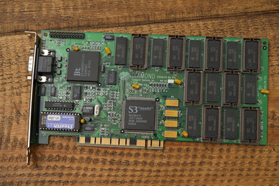

This Diamond Stealth 64 VRAM which looks like one big cache of VRAM chips will be handling DOS/Windows 3.1 graphics.
458.65 KiB
4062 views

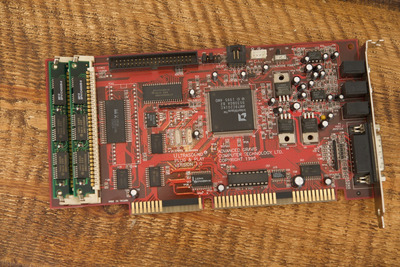

And the sound will be provided by this Gravis Ultrasound P&P Pro (also with maxed RAM).
459.25 KiB
4062 views

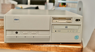

And I’ll put everything into this Dan PC desktop case I salvaged from another PC of that era.
166.69 KiB
4062 views

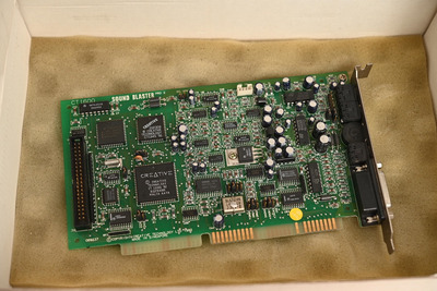

Reply 3 of 31, by mpe
Makes sense. GUS SB emulation sucks. Let's put in this Sound Blaster Pro 2.0 for SB compatibility.
338.33 KiB
4018 views

Reply 7 of 31, by mpe
Intel486dx33 wrote on 2020-03-09, 10:21:
The SB AWE64 has better sound quality than the SB Pro 2.0 in my opinion.
Yes could be an option. I expect newer stuff to be using the GUS which plays just as well in many games.
The purpose of SB Pro 2.0 is just to have compatibility. Unlike SB16/AWE32/AWE64 can do stereo in SB Pro mode and has true OPL3 😀
Blog|NexGen 586|S4

Reply 9 of 31, by Anonymous Coward
Nice Pentium. That's a pretty rare chip. It's a P66 which is way less common than the P60, plus it's in mint condition, and it says "Processor" which I believe makes it somewhat more collectible.
Reply 10 of 31, by jheronimus
Just wanted give a heads up — a Soc4 Pentium really needs at least a heatsink. Better yet, some active cooling — this is definitely one of the hotter chips of the era. You probably just wanted to make some beauty shots to show off the golden cap, but better safe than sorry 😀

Reply 11 of 31, by Anonymous Coward
I would use a beat up P66, and put this nice one in display case.
Reply 12 of 31, by mpe
Sure. The above CPU will remain on display. For the actual use I always use another P66 with stock heatsink/fan glued in. I hate scratching these CPUs too.
Talking about putting rare S4 CPUs on display. I also have this early all-ceramic P60 part that is perhaps even more collectable. I never mount a heatsink on that one. Although it does seem to have some thermal pad marks from its past life.

Reply 13 of 31, by matze79
i searching a 66Mhz Pentium for ages.. i only find the 60Mhz parts, are the 66Mhz parts so rare ?
Reply 14 of 31, by Anonymous Coward
Yeah, the 66MHz parts were far less common for a couple of reasons. Intel had problems producing enough of them initially. Then there were stability issues, so they had to increase the recommended voltage from 5.0V to 5.15V. Plus not all socket4 boards were up to the task of offering a 66MHz FSB...and even when 66MHz was an option, it was often not faster than a well tuned 60MHz system. My guess is that all the extra wait states to the RAM and cache memory killed any potential performance gain (10% at most).

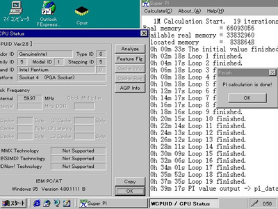

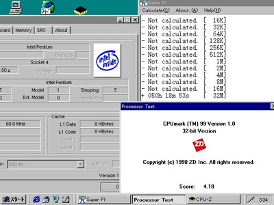

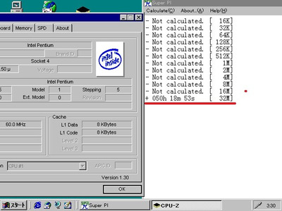

Reply 19 of 31, by Ponjiayulady
Pentium 60Mhz real performance
