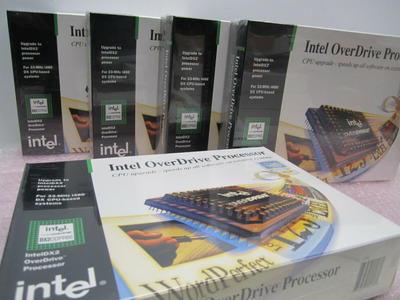

hi,
i know about 3 editions of the dx2-66:
* naked, as oem cpu
* overdrive as retail cpu (boxed)
* blue heat sink version? where they use it? what was the reason of this edition?
i did not find any info about it. originally i thought this cpu was the retail, but from the newspapers looks the overdrive was it.

Reply 5 of 16, by arncht
brostenen wrote on 2020-03-14, 11:49:
I have seen tons of different coloured heatsinks on 486's. I had a gold/copper-coloured one on a 486-dx2-66 in an IBM at some point.
The glued on heatsinks, just came in whatever colour, the maker of a given machine chose to use. Basically it is just a standard CPU.
these are the intel official heat sinks (the blue and the overdrive). the question: was the blue sink version an oem or a retail product?

Reply 6 of 16, by arncht
here they write... boxed
http://www.cpu-galerie.de/html/intel486-80486dx2.html
but how the box looked? the overdrive is obvious.

Reply 8 of 16, by arncht
thx... with this type of blue sink? in this case it looks, the blue version is also an oem solution.
Overdoze of the demoscene
Reply 10 of 16, by arncht
derSammler wrote on 2020-03-15, 11:14:
No, that's the normal retail boxed release. OEM had no heatsink at all.
where is the box? i did not see any, just overdrive boxes.
Reply 13 of 16, by BitWrangler
I've seen them, but last one I saw in the wild was about 345 moons ago.
Reply 15 of 16, by waterbeesje
I've got one, it was found in a dead HP Vectra ISA only system.
It's a regular DX2-66, blue sink glued with all the Intel printings on it. To me it seems like an Intel product, not glued by hp.
