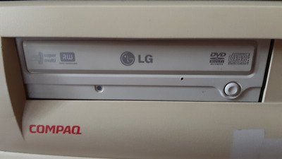

First post, by Juan-san

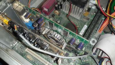

Motherboard: Compaq 06C4h (Intel 815, non B-step)
Processor: Pentium III 800EB 1000EB
RAM: 256MB (2x128) PC100 PC133
Graphics: XFX GeForce4 MX440-SE 64mb DDR (64-bit bus) Zogis GeForce FX 5500 256MB/128bit DDR
Sound: Sound Blaster Live! X-Gamer (CT4760)
HDD: 80GB WD800BB
ODD: HL-DT-ST GSA-4163B
OS: Windows 98 SE + XP SP3 2000 SP4

Future plans:
.Get a P-III 1000EB (fastest CPU supported by this board)
Done
.Replace the MX440-SE for something better and with a 128-bit memory bus. Done
.2 sticks of 256MB of PC133 RAM. 2 of 128, doesn't want 256MB sticks running at 133mhz(?)
.Move to an ATX or micro-ATX case, plus new PSU. Nah?
.Find a working 3.5 FDD to flash the BIOS (686P0 v1.10 to v2.04), 'cause a Gotek is too expensive. Done
The reason for the BIOS flash is because the current one isn't allowing Win98 to manage system resources (adding a second PCI card causes a conflict), and there is no option for PnP OS in the system's setup screen, so I want to check if a newer BIOS can fix this. It didn't

Reply 1 of 13, by Scraphoarder
We had a dozen of those at work and two were saved, but have not decided what to do with them. I remember this was the first Deskpro where the build quality felt seem to be substandard compare to the battle tanks that came earlier. They probaly saved some in materials and shipping costs. Anyway, Deskpros are becoming rare so i would keep the MB in its original case.
Reply 3 of 13, by chinny22
Nice little Win98 box and desktop means stackabe or put under a screen.
and yeh while they weren't tanks like earlier Deskpro 2000/4000's We had the related SFF's and they were still pretty solid.
Reply 4 of 13, by Juan-san
Thank you all!
The driver I used for the Live is 4.12.01.0905 VXD (used by Phil on his video), which I got from the Vintage Driver Library.
As for the case, I won't thrash it, but will give way. The yellowed plastic, top cover scratches, and the gaps between the 5.25 drive and the front panel have become an eyesore for me, besides the fact that I have to remove anything on top of the case if I want to do hardware alterations.

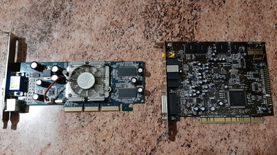

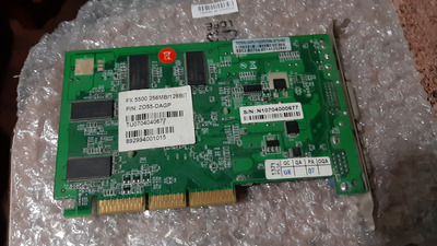

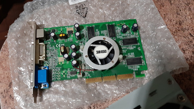

With a change in graphics card came a title change for this thread.
The MX440-SE began to give signs of impending death a month ago (was my third one to give the ghost yesterday, all of them XFX cards, same model, in the lapse of two years), so I began looking for a replacement and ended up with this a week ago.

Yay, my first time getting my hands on a full-height AGP card with a 128-bit memory bus. None of that low-profile & 64-bit bus garbage.

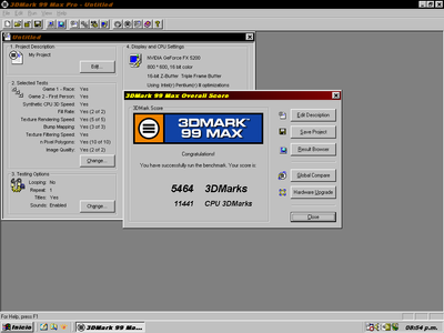

Reply 9 of 13, by Juan-san

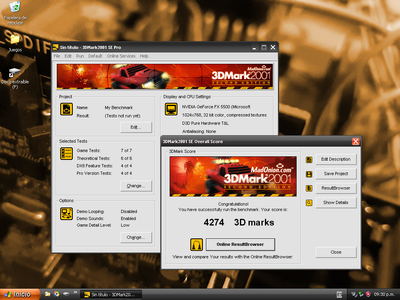

35.63 KiB
1841 views
3DMark Result: 5.464 3DMarks
Synthetic CPU 3D Speed: 11.441 CPU 3DMarks

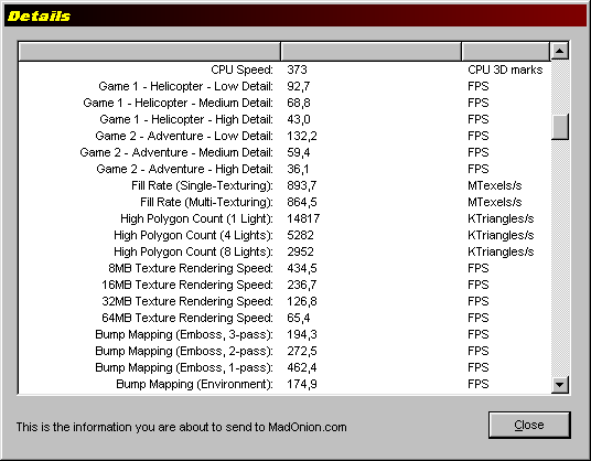

9.65 KiB
1841 views
For a lesser update, I shrank down the 98SE partition via Gparted in Puppy Linux to make way for an XP SP3 install, in which I'm installing anything that requires DirectX 8 or 9.
554.86 KiB
1841 views

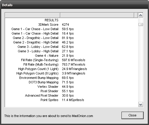

9.3 KiB
1841 views

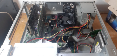

Reply 12 of 13, by Juan-san

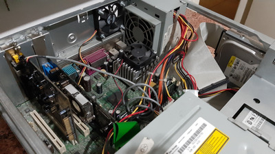

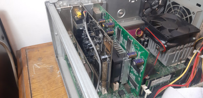

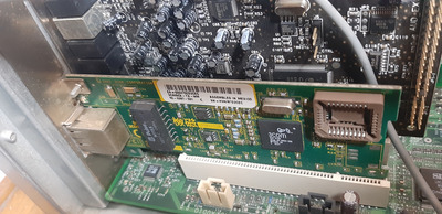

Updating this after almost 3 years.
Swapped the 800EB for a 1000EB, upgraded the 686P0 BIOS to v2.04 to get rid of the missing processor microcode patch error (it didn't add any other stuff), swapped the PC100 sticks for PC133 ones (2x128), and installed a network card. I'm done touching this PC's internals.

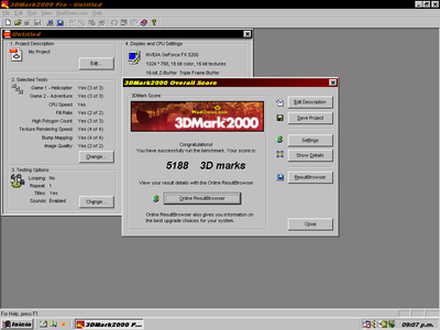

Benchmarks
    10.48 KiB
    938 views
    3DMark2001 SE
    10.9 KiB
    938 views
    3DMark2000
    11.93 KiB
    938 views
    3DMark99 Max

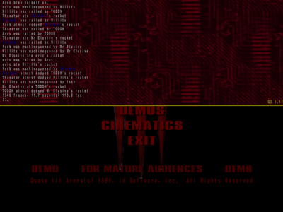

    255.34 KiB
    938 views
    Quake 3 Arena 1.11 timedemo demo001 1024x768x32
