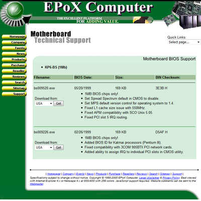

After installing OS, Intel 82371AB/EB PCI to USB bridge is giving me exclamation mark with error code 35:
“Your computer’s system firmware does not include enough information to properly configure and use this device. To use this device, contact your computer manufacturer to obtain a firmware or BIOS update. Code 35”
Not much helpful info can be found with google. Somewhere was a comment that MPS version should be dropped 1.4->1.1 but cannot remember is there even this configuration available. BIOS update could be one solution, but Epox BIOS updates are not easy to find. This is with 1Mbit BIOS chip. I found one firmware file but it seems to be with the same date (05/99) that is currently in the system. Any suggestions? I don't care much about USB, but it would help a lot installing all drivers and stuff...

Think you're already on the latest bios version for the 1Mb chip. MPS Version Control is an option in BIOS FEATURES SETUP
FYI, bios downloads are available here http://www.elhvb.com/mobokive/Archive/Epox/bios/index.html

About the USB driver issue, with a little patience I found MPS 1.1 from the BIOS menu and it works fine now.
