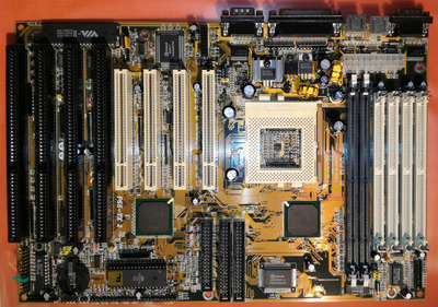

Decided to build a system around this board:

There are a lot of unknowns about the final configuration, but I'm aiming for a Riva128 PCI+ possibly dual VooDoo2 (if both my boards work).
The CPU will be a K6-2 at 400MHz (66x6.0).
The problem is related to the CPU voltage, as the board only offers 2.0 and 2.1 volts and then jumps to voltages that are inappropriate to a K6-2 (2.8, 2.9 and 3.2 volts).
I have a tray of 10 NOS K6-2-400AFRs that require 2.2 volts, do you think picking a random one and sticking it to the board will result in a stable system at 2.1 volts?

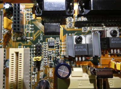

Tried to replace the voltage selection jumper with a resistor, used 100ohm to 1Kohm and nothing changes. Can't decipher the inner workings of this VRM.

I think most 2.2V K6 cpus will work fine at 2.1V - no underclocking necessary, but don't overclock. And yes, you should run programs with high cpu-load and test the stability to be on the safe side.
K6-III cpus requiring 2.4V will not work, there were also 550MHz ones requiring 2.3V which will be problematic, too.
A good test will be a 2.2V K6-2 500 at stock speed @2.1V, when that works stable you won't have any problems with 400MHz neither in my opinion.
Maybe the 2.1V setting results in 2.2V anyway, you would need to measure it. I would not worry about it, when it works. You don't take big risks with undervolting, the system could crash of course.

The 2.1 setting on the board actually yields 2.132 which is encouraging.
Tried with no voltage jumpers at all and it remains at 2.074 - same as with the jumper on "2.0V". I don't dare testing combinations of 2 or more jumpers; this is my only full-ATX Socket7 board.

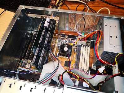

Recapped the motherboard, cleaned, recapped and added -5V output to the Delta 250W PSU I had lying around, made some small mods to the case (either it or the motherboard are not exactly ATX standard and many of the mounting holes were in the air), repaired/modded the NEC-chipset USB2.0 card which looks like it had a hard life - missing SMD resistors, one USB connector badly burned - I removed the internal connector and replaced it with a header to be able to use at least one front panel USB.

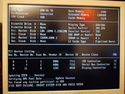

The hard drive is a Barracuda ATA IV 40GB limited to 32 via the jumper, otherwise the board would hang at IDE detection. Very happy with its speed, wish I had something comparable back in the days 😀
But, how about this? UDMA5 on the PIIX4? This surely has to be a mistake. I used a 80-wire cable for the HDD, since i have plenty of them NOS, which can't be said about the 40-wire ones that are battered and worn.

Both Voodoo2 cards are in order, but getting a bit hot for my liking so more testing will be done after fitting a 120mm fan to the side panel. I used the FastVoodoo2 3.6 drivers but in the meantime found out there is a 4.0 version so I will update them tomorrow. (disregard that. I'm using v4.6 and I think it's the latest). Only tested 3dmark99 today, scores are 583 for the Riva128, 1425 (Voodoo2) and 1780 (V2 SLI). I was expecting nearly double in SLI vs. single, but perhaps I'm hitting the CPU limits. I know there's more tinkering to come, including testing with 64MB RAM or going all out with 256.
Still haven't decided about the sound card, but I'll probably go with the Aztech Sound Galaxy Waverider 32+.
More pics...

To be absolutely safe about data integrity, you may limit max HDD UDMA mode to UDMA2 by special tool. For Seagate it is UATA100.exe
