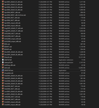

It comes with a DirectX 9 (November 2006) setup and OpenAL setup which I have already installed. How can I find what version of Visual Studio the game was compiled for?
    12.07 KiB
    2453 views
    323.6 KiB
    2453 views
