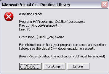

- Created the following DOSBox configuration file named "modem.conf":
[modem]modem=truecomport=2listenport=23 - Launched DOSBox with "-conf modem.conf"
- Ran BananaCom (renamed as BCOM.EXE).
- Added a new dialer entry: 192.168.1.102.80
PS: I now know this entry is illegal. - Tried to connect to my new entry.
- After a couple of minutes of inactivity, suddenly this dialog box showed up:
Microsoft Visual C++ Runtime Library
(X) Assertion failed!
Program: H:\Program Files\DOSBxo\dosbox.exe
File: ../../include/serialport.h
Line: 70
Expression: (used+_len)<=size
