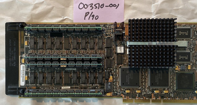

In contrast here is the original board that came with my XL, labeled 003510-001, with a P90 under the heatsink, also Socket 5. Here, there are only 4 slots for memory, the board layout is different, and there is no fan header above the CPU. I also have two other XL boards (P60 and the 486/66) I purchased many years ago; neither is socketed nor tested (never got around to it) but both boards also have 4 RAM slots. The 486 is socket 2; the P60 is Socket 4.
1.56 MiB
732 views
Compaq 003510-001 P90 Processor Board
I'll PM you directly but wanted to share this information here for posterity--it's hard to find information online about these computers.

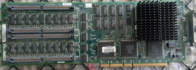

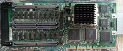

Reply 14 of 32, by eisapc
O.k. here are the two XL boards I found:
Assy 004024-102 Spare 148238-001 50 MHz Socket 4
Assy 004843-006 Socket 5
This should be 120 MHz but a 90 MHz CPU is installed.
For the M I found a backplane, 3 486 4MB Boards Assy 002501-101, and -011 and 3 memory boards.
I need to have another look, there must be some more boards.
But have to do the voltage measurements for you first.

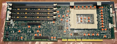

I finally found the Pentium Pro processor board and it should arrive in a couple of days--I will post pics when it does. I'm excited to see how far I can push the XL chassis. 😀

Reply 18 of 32, by Swiego
Good news, I finally received a pair of what I believe are the Pentium Pro boards for the XL. I have only unwrapped them and likely won't have time to try them for a few days but here is a picture:
1.29 MiB
571 views
Deskpro XL Pentium Pro 210911-001

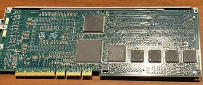

Edit: here's a picture of the rear which I didn't include originally:
1.35 MiB
514 views
Deskpro XL Pentium Pro 210911-001 Rear
Both boards look new. The rear has quite a few very large Intel branded ICs. The RAM slots are different from my existing boards so I have to check my stash to see if I have anything compatible. There also are two connectors on the board below the RAM slots whose purpose I cannot discern. Lastly, I have a PPro 200 (256kb) en route so until that arrives, I cannot do much with this thing. Happy to take requests though.
I'm still concerned that the PPro XL units utilized a newer system / IO board and I'll run into problems trying to use this on my existing computer.

Reply 19 of 32, by mpe
The PPRO card looks great. But I wonder if a CPU card with such a little glue logic can really work on system boards designed for Pentium (or even 486?). Are this cards compatible as soon as they fit into the slot?
I have this system board (004321-001 or 004320-001). I am trying to find out if ti can take the CPU card that looks just like P120 one on picture above. But I have just the board - no PSU. Could someone with working system post/measure the connector and pinout? Ot is it documented somewhere?
