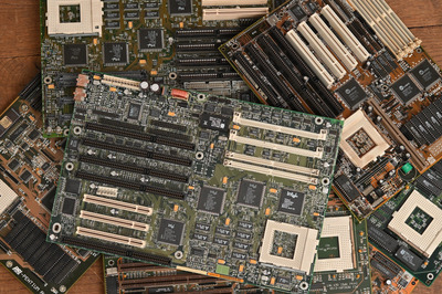

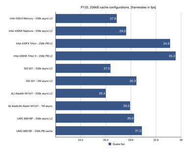

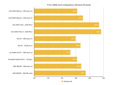

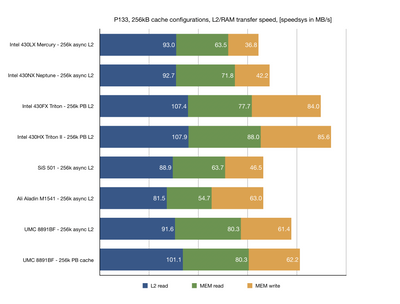

I am working on a project, where I am comparing performance of some selected early chipsets from Socket 4 and Socket 5 era. So far I've tested the the following:
  • Intel 430LX (Mercury)
  • Intel 430NX (Neptune)
  • Intel 430FX (Triton)
  • Intel 430HX (Triton II)
  • ALI M1451 Aladdin
  • UMC UM8890
  • SiS 501
1.28 MiB
2827 views
I got the first results in and I thought it might be interesting to share them. Unsurprisingly, Intel Triton runs in circles around the competition. However, there are some nice 3rd party choices too. I was surprised by strong result of UMC8891BF chipset which reportedly has 486 architecture (which I found not to be true).
This is still WIP and I'd like to cover more chipsets from this era. Specifically different revisions of UMC, Intel chipsets with different cache configurations, SiS 5501, Opti Python/Cobra/Viper and more.
241.92 KiB
2827 views
233.91 KiB
2827 views
More details are in this blogpost.

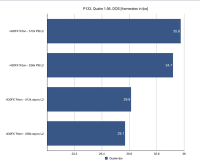

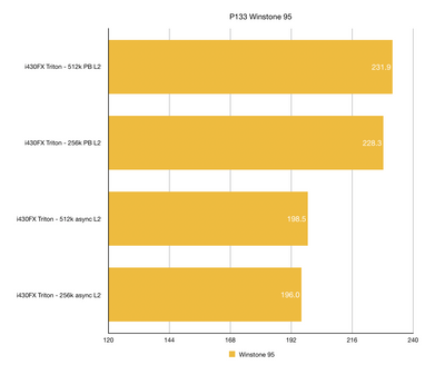

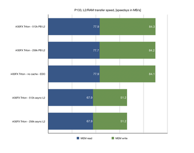

Finally found a Triton motherboard which can run both pipelined-burst as well as asynchronous SRAMs + some 512k PBSRAM COAST modules.
Looks like the Triton chipset benefits a lot from the PB cache. Much more so than the UM8891BF. According to datasheet the Triton can only do 4-3-3-3 writes with async cache so there is no surprise it can be beaten even by its predecessors. The UMC
can also do both cache types and doesn't have such a big gap.

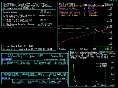

Unfortunately I don't know what memory modules I've used for it. It's from a Deskpro XL with the Pentium 133 CPU module installed. I don't have this system anymore. Here are the results:
Cache/Memory Benchmark
│ Read │ Write │ Move │ Average │
│ Cache Level 1 │ 170.52 MB/s│ 64.52 MB/s│ 507.45 MB/s│ 247.50 MB/s│
│ Cache Level 2 │ 107.88 MB/s│ 64.09 MB/s│ 128.05 MB/s│ 100.00 MB/s│
│ Memory │ 58.58 MB/s│ 29.13 MB/s│ 39.45 MB/s│ 42.39 MB/s│
    11.77 KiB
    2526 views
    Deskpro XL 133 System Speed Test results

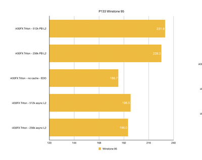

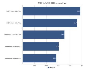

This is actually very interesting. I mean the perspective of the cache-less config. As soon as you program the 430FX chipset to use asynchronous cache the write performance tanks:
149.35 KiB
2480 views
With write-heavy Quake test being hugely affected:
122.76 KiB
2480 views
Fortunately, not every program is like Quake and despite async cache fighting an uphill battle on write-crippled memory bus, the marginally improved read latency of async cache can still produce some measurable gains in "normal" apps:
121.14 KiB
2480 views
I've seen this on two Triton motherboards with both chipset steppings. From Triton datasheet it is clear that when async SRAMs are used, the write latency goes up to 4-3-3-3 which is higher than on previous Intel chipsets . It can't be programmed by BIOS or registers so this is a feature of Triton 😀
I think this must be either a chipset bug they never bothered to fix (or a deliberate choice?). None of other chipset is showing this (and none of later Intel chipset supports async SRAMs).

So, in some cases, NO cache is faster than async cache? Are the async cache tests also with EDO?
Reply 16 of 42, by mpe
I tested all combinations. The above is all EDO. The benefit of EDO is twice as big in a cache-less system though.
This is somewhat in line with Intel's marketing message they were pushing back in 1995, that EDO (or hyper page ram how they call it) is a cost effective alternative for expensive SRAMs...
One could say they crippled async cache support in Triton to be able to make that claim 😀
