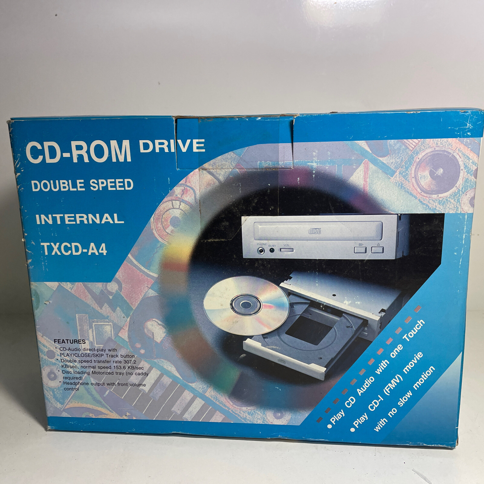

Reply 13 of 15, by Robin4
This could be the same drive
https://www.ebay.com/itm/195671468271
just google on TXCD a4.
Picture saying its a sony bus.
Some features on the box
Saying its a dual speed drive.
Reply 14 of 15, by matze79
This Drive uses same Chipset
Attached driver too.
