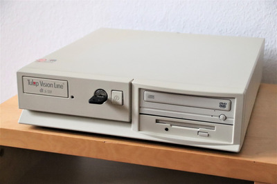

I was able to acquire this Socket 7 system that I am nostalgically attached to and that I have upgraded to suit my DOS/Win95 retro computing needs:
219.58 KiB
480 views
Tulip Vision Line dt - Front View
Background Story

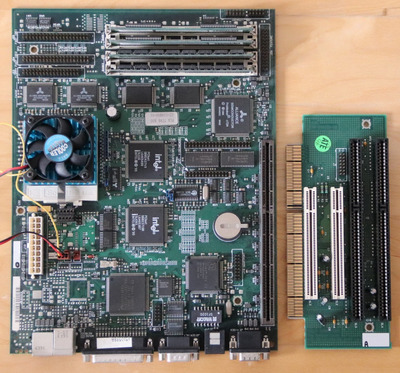

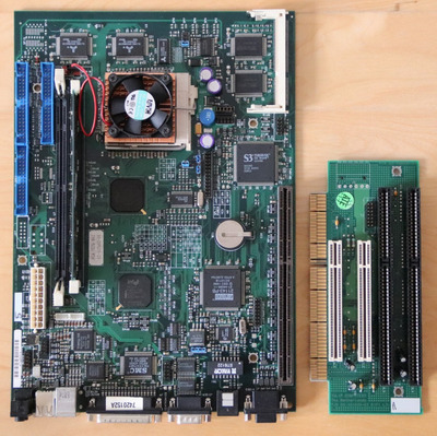

The Vision Line dt came with at least two different mainboard models, both Socket 7. The earlier TC48 used the Intel 430VX chipset while the later TC76 uses the 430TX.
Of the TC48 there are at least two different variants, one does support split voltage (MMX) processors, the other one doesn't, because it is not fully populated with the required components.
Only a few days after receiving my unit, that was equipped with the TC48 in the non-split-voltage version, I found a TC76 on eBay and got it for 15€ shipped.
TC48 specs
  • Socket 7
  • Intel 430VX chipset
  • MMX- and Non-MMX models available
  • 4 RAM Slots (72-pin EDO RAM SIMM)
  • Alliance Semiconductor AT24 onboard graphics, 1MB RAM, proprietary upgrade module
  • AMD PCNet 10MBit Ethernet onboard
  • Probably models with onboard sound available (solder spots on the PCB are there)
360.21 KiB
480 views
Tulip Vision Line dt - TC48 Mainboard
TC76 specs
  • Socket 7
  • Intel 430TX chipset
  • MMX-capable
  • 2 RAM Slots (168-pin SDRAM DIMM)
  • S3 Virge/GX onboard graphics, 2MB RAM, upgradable with 2MB SGRAM SO-DIMM module
  • DEC 21143 100MBit Ethernet onboard
  • Creative Soundblaster Vibra 16X onboard
  • supports booting from CD-ROM, which is definitely a plus
340.07 KiB
480 views
Tulip Vision Line dt - TC76 Mainboard

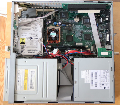

Building my Vision Line

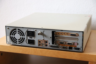

My goal with this system is to use it as my main retro system for Windows 95 and DOS gaming. To achieve this, I made the following changes to the original system:
  • Replaced the TC48 mainboard with the TC76 from eBay
  • Installed a Pentium MMX 233 MHz
  • Upgraded RAM to 64MB
  • Upgraded Video Memory to 4MB
  • Installed a HDD, obviously. Currently IBM 20 GB, which exceeds the BIOS limit of 7.9GB, but works OK
  • Installed an optical drive, currently some early 2000s DVD drive that I had at hand and that had a matching color, will be replaced with something more period correct later
  • Installed a 3Dfx Voodoo 1 4MB
  • Installed a Terratec Maestro 32/96 sound card
  • Updated the BIOS to the latest revision that I was able to find (thanks to archive.org)
  • Replaced the floppy drive that was working nicely with the TC48 but refused to work with the TC76
219.58 KiB
480 views
205.69 KiB
479 views
Tulip Vision Line dt - Rear View
280.17 KiB
479 views
Tulip Vision Line dt - Top View
Upgrade Considerations and To-Dos
  • It still has one free slot (combined PCI/ISA) left, so I might add an MPEG decoder card, SCSI controller or IDE controller later. Not decided yet.
  • Maybe replace the Voodoo 1 with a Creative Voodoo Banshee PCI, which is not 100% period correct and would probably not be saturated by the CPU, but I have it at hand and it would ensure there are no limitations GPU-wise.
  • Replace the HDD with the 8GB IDE DOM that is currently in use in my other, Tyan-based Socket 7 430TX build
  • Replace CPU and power supply fans with modern low-noise alternatives
  • Obviously get rid of that DVD drive. I have a 1997 (and therefore period correct) Creative DVD drive too, but it's yellowed quite badly so it wouldn't match the color of the front bezel.
The OS of choice is obviously Windows 95 OSR 2.5, nothing special. It turned out to be a bit tricky to find the drivers for the ethernet controller and the 430TX power management controller, though.
Current Issues
  • The onboard sound chip (Vibra 16X) is not detected at all. There are no options to enable or disable it in the BIOS. Maybe a jumper that I have not found yet, but I doubt it.
  • Upon warm reboot, the system refuses to start. Screen stays black, does not POST. No idea why.
Bottomline: This is a fairly compact but very capable little machine that brings back lots of good memories and will definitely stay in my collection.

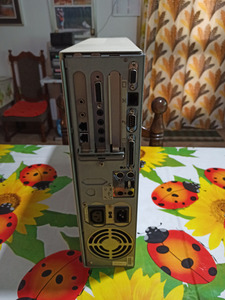

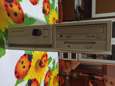

Reply 9 of 10, by Scandy
And here it is!
y4m3OQPdDRgvVCGhIJB6yLnr_ILhEsPMQCN6Wm5Qq6EB0r2KD6tupuDjPcRLKJuXAnI2HkvcIipqiQ9_2FIPAIErCWdUHL_yl8aqEZBLQ0jzjF5__pq_tBzIoisiTk4oFR4lJ6s7Z_0tkpS28l_T6TSuHjdSnxfg6J1nnFFe88w4Ghms5fh4DZ0QXnwRrTz6lxT?width=768&height=1024&cropmode=none
- Intel Pentium 166 Mhz
- 48 Mb RAM
- S3 Trio 64v+ (PCI)
- Creative Sound Blaster AWE32 (ISA)
- SD (4Gb) to IDE adapter
- MS-DOS 6.22
It's in PERFECT shape, cleaned and fine-tuned. I just need some shorter IDE cables for a better "cable management", and I should also investigate on why sometimes the CPU is detcted (on other softwares, not in bios) as 200 Mhz.
Now I need a beige CRT, I know!
THE NIGHTLAND is my board + video game for Commodore 64.
Reply 10 of 10, by gex85
That's a beauty, thank you for sharing! I am glad that one more of these nice little machines has found its way to a collector instead of the recycler.
