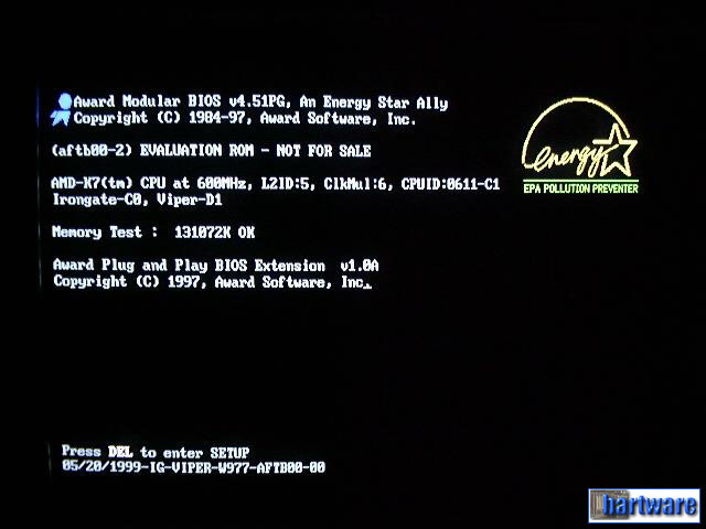

Reply 182 of 212, by Deksor
Well if you want to have the correct aspect ratio, you have to stay with 4:3.
Best way of doing it is apparently to scale the image vertically three times and then scale it to proper aspect ratio with bilinear filter.
So if the image is 640x350, you'll have to scale it to 640x1050 then scale it down to 640x480
Here's how the POST screen looks like on a monitor
Here's the POST screen unscaled
8.62 KiB
1196 views
and here's the POST screen scaled
15.04 KiB
1196 views
Much better isn't it ? 😉
Same happens with games by the way
