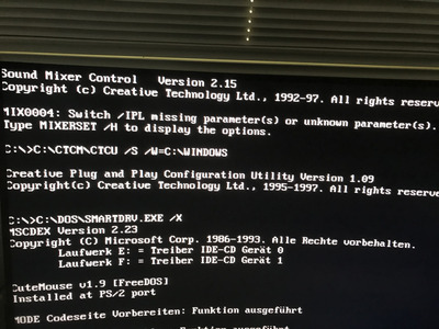

I did a clean install of SBBASIC and CTC Dos driver from Phils page (DOS 6.22 + win 3.11). I use a CT4170 SB16.
Anything work fine but i got a missing or wrong parameter when i load my mixer preset:
1.53 MiB
777 views
It stops at the IPL switch.
Here my ctmix.cfg:
870.37 KiB
777 views
I notice that the IPL is only on preset and not on the load blog. I put in the IPL line and after that under load, but this dont help.
Can someone tell me whats wrong? As i say its a clean new install. Just wonder what parameter is not set??

Reply 4 of 11, by Gmlb256
Not all SB16/AWE variants has every mixer parameters. For example the Vibra variants lacks the bass, treble and gain control settings, and the AWE64 CT4520 only lacks the gain controls.
Try removing the "bad" parameter from the CTMIX.CFG file.
Reply 5 of 11, by Jackhead
My solution was switching the soundboard. Im using a CT3980 now, without any problems.

Reply 6 of 11, by Gmlb256
Jackhead wrote on 2021-09-02, 05:52:
That's much better card than the SB16 CT4170, with real OPL3 and proper high DMA support.
