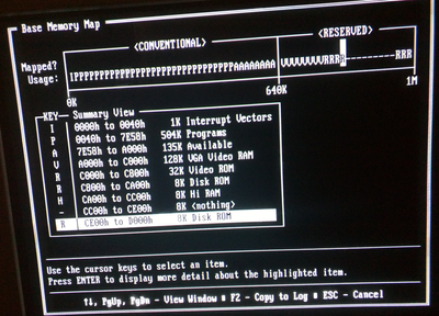

Hi, can you run CheckIt! off the floppy disk ? If so, check the memory browser.
It's just a wild guess, but maybe the controller's ROM is conflicting with the memory location of the framebuffer.
Textmode appears on two positions, depending of the graphics card (CGA/MDA etc).
Perhaps that's why it works.
Anyway, it's just an idea. Maybe fellow vogons users can help figuring out the issue..
Good luck! 😀
Reply 2 of 8, by dunarea
I checked .
I'll abstaint to evaluate and leave it to more experienced guys.

    checkit 3 I/O output

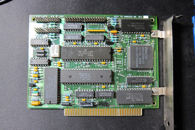

Reply 5 of 8, by dunarea
The controller is an HC-100 Transteque with dynamic configuration. Jumperless.
I set the interleave to 6 on my V20 XT machine. Tried before 3, 4 to 1 interleave and symptoms were the same.
The xtidecfg executable runs well with his ANSI interface, and is big enough to span many cylinders. Other software, no. Not even edit.com.
What is strange is if I pull out the MFM controller and use only the XTIDE-CF card, everything is fine. It is like that BIOS has something better inside...

Reply 7 of 8, by dunarea
Finally found a ST412 MFM interface... Now it works. Tested good with Prince of Persia.
