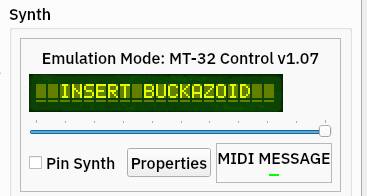

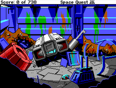

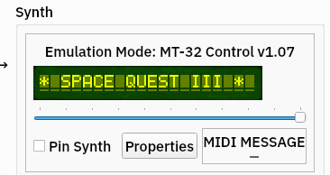

Reply 9 of 12, by krcroft
30.76 KiB
1908 views
13.76 KiB
1908 views
13.83 KiB
1908 views
