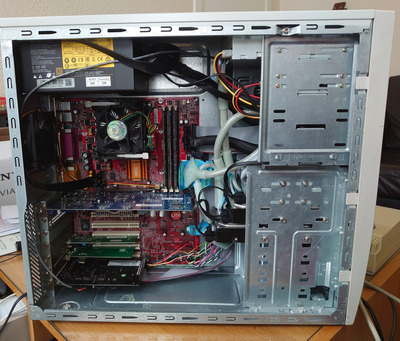

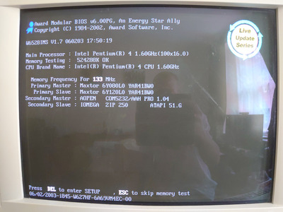

i like to share my build for my windows 98se build and took a long while to build and find/try out different parts and games to see what works best for me for now and might be upgrades/downgrades or changes in the future
specs are :-
Motherboard - MSI MS-6528lE
PSU - Seasonic M12 II EVO Bronze 520W (Will be downgrading at some point)
Processor - Intel Pentium 4A - 1.6 ghz (Northwood)
Ram - 512 MB (Offtek SD-RAM PC-133) (1x 256MB + 2x 128MB)
Graphic Card - Albatron GeForce 4 TI 4200 Turbo - 64MB
Sound Card - Sound Blaster Live 5.1 Platinum
Ethernet Card - TP-Link TF-3200 - 10/100m
Firewire Card - Pluscom 4 Port Firewire Controller PCI Adapter
Drives
- 1x 3.5 Floppy (720KB - 1.44MB)
- 1x 3.5 Iomega Zip 250 ATAPI (100MB - 250MB)
- 1x Aopen COM5232/AAH PRO Combo CD-RW/DVD-Rom
- 1x Maxtor Diamondmax Plus 9 6Y080L0 - 80GB
- 1x Maxtor DiamondMax Plus 9 6Y120L0 - 120GB
I/O Ports
- 4x USB ports (2x on Mobo + 2x on Case)
- 2x PS/2 Port
- 2x DB-9 M Serial
- 1x DB-25 F Parallel
- 2x VGA (Mobo - DISABLED) (GPU - ENABLED)
- 1x DVI-D (GPU - NOT USED)
- 2x Gameport (Mobo - DISABLED) (Soundcard - ENABLED)
- 1x On-Board Audio (DISABLED)
- 1x Ethernet Port
- 3x 6 pin Firewire Port (2x External) (1x Internal)
- 1x 4 pin Firewire Port
Extras
- Sound Blaster Live 5.1 Platinum - 5.25 I/O Bay
- 2x 80mm Case Fan
- PS/2 Mouse + Keyboard

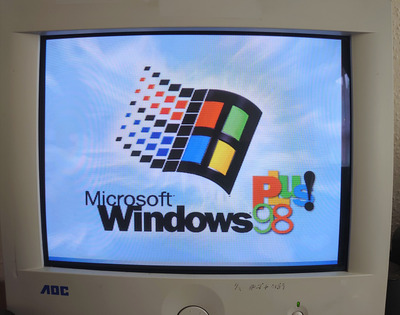

Operating System
- Windows 98se (with Plus Installed)
UPDATE
Unfortunately the mobo died ages ago and but managed save the rest of parts and will posting a new build post for it soon even though it will more of less be the same as this one
