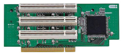

I never tried a card like that. I have a feeling its a scam. You need a card that has an integrated PCI to PCI bridge chip. All of the multi slot riser cards that I ever tried had paddle boards for each additional slot and mapped slots 1 to 1 ratio and didn't have pci bridges.
You need something like this with a bridge on it. Because you only have 1 PCI slot. You do not have 2 slots that you can terminate to.
I actually have a couple of these cards I picked up a while back. Haven't had a chance to try them out yet though.
Here is the datasheet for the bridge chip:
PI7C8152MA.pdf
1.4 MiB
60 downloads

Reply 8 of 9, by Warlord
On my EPIA you can add a specific 2 slot riser. It's not a generic riser like that and it has a chip on it. It splits the slot into INT A and INT B.
https://www.ebay.com/itm/EXT-PCI-riser-one-PC … esAAOSw0IJZ25Or
