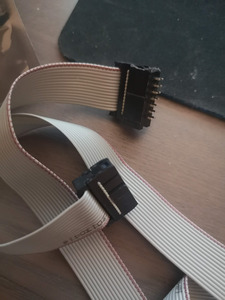

Since yesterday I am a proud owner of a Canopus Pure 3D II card. Since I also have a Canopus Spectra 2500 I would like to use the internal pass through possiblity instead of an external cable. This pass through cable was unfortunately not in the package. Does anyone have the cable and could provide me with pics of the cable?
I guess it will not be possible to find a pre assambled cable?

From what I remember it's just a 10 pin cable, like this one:

Here is the picture of the cable I made myself. I purchased a 14 pin cable (female to female) and then a 14 pin socket which I just attached to the end and cut off some of the plastic.
