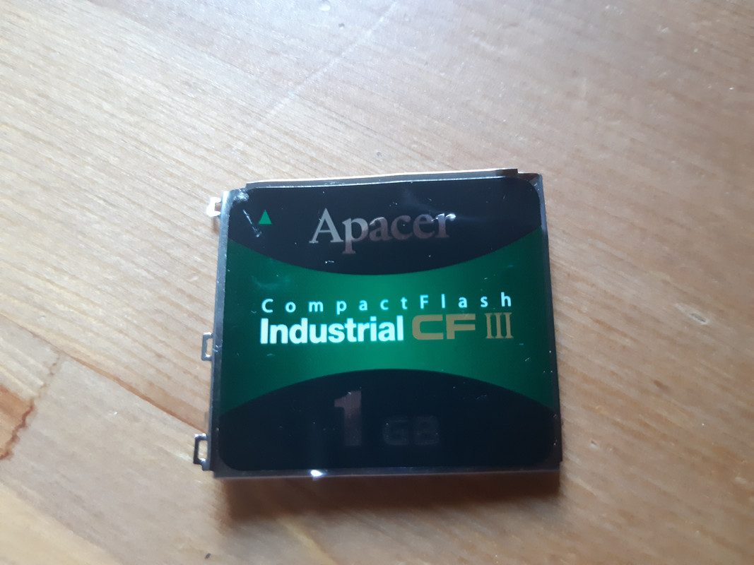

Picked up a couple of these "industrial" CF cards in a job lot the other day.

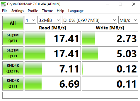

First thing I did was test the read/write and manufacturer information, and it's pretty abysmal. Unfortunately, given the insanely rampant fake card scene on eBAY and the likes, I have serious doubts they are genuinely industrial or SLC.
Can anyone please help in sleuthing out whether these are lemons?
Here is the manufacturer's specsheet:

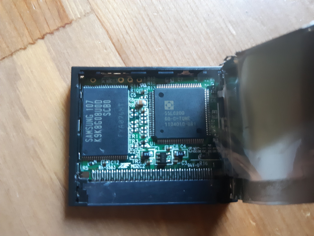

Sacrificed for science.

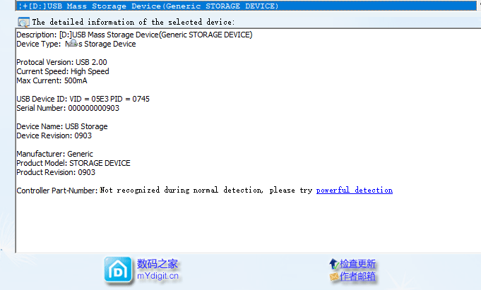

ChipGenius returns "STORAGE DEVICE" but am not sure whether this is due to the card read/hub I'm using.
Wow, that random writes figure is terrifying.
