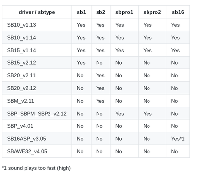

Reply 12 of 81, by ripsaw8080
Rank DOSBox Author
DOSBox Author
FYI, each CT-VOICE driver is programmed to only work with a specific model of SB, which it does by checking the DSP (chip) version on the card. So, I guess the numbers are baseport (220), irq (3,5,7), and DSP version.

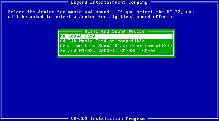

Regarding "Spellcasting 101: Sorcerers Get All The Girls", I think that only applies to the diskette version. I have the version from "The lost adventures of legend" compilation CD, and I don't need to load SOUND.COM
When I run the games SETUP.EXE it gives me these options
5.76 KiB
8599 views
But the manual of the disk version of the game indeed talks about loading SOUND.COM

Regarding "Spellcasting 101: Sorcerers Get All The Girls", I think that only applies to the diskette version. I have the version […]

That would make sense, as the later versions (201, 301) did not seem to need it iirc.
Thanks _Rob, adding a note to the list.

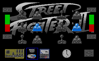

@Calvero:
You submitted Street Fighter II to the list, after some testing I could get sound effects with:
  • setting sbtype=sb16 in the conf (which it is by default)
  • copying in the SB16ASP/CT-VOICE.DRV replacing the original 'SBDRIVER.DRV'
  • making sure that the CT-VOICE.DRV was patched to irq7 (original was set to 5)
Also it's easy to test in the options menu, which makes this an excellent example 😁
Thank you very much!

Reply 19 of 81, by Akuma
Tested Street Fighter II by switching sbtype's and drivers (that are patched to use IRQ7)
In conclusion: the SB1.0/SB1.5 v1.x drivers are the most compatible, and there was a bug when testing the SB16 driver.
28.17 KiB
8498 views
GPL-2.0-or-later
Is there a way to create a table in the forum ?
(I feel like a bit of a moron pasting it in like that)
