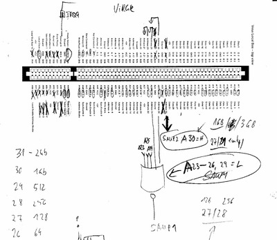

I make a notice about their trace: YEAH, it runs in LPB-mode and SAUP2 is wired direct to address line 30.
here a scanned notice.
The attachment IMG_0001.jpg is no longer available
The attachment STB_powergraph64video_pinout.png is no longer available
SAUP1 is asserted in 0-8MB i/0 address range, and it morrored at 128 ; 256 ; 384MB address range. (also it replay same with 2GB offset)
SAUP2 is asserted in 1 & 3 GB I/O address range, not at 1024MB (there is SAUP1 also asserted.) -> above 1032MB Address range.

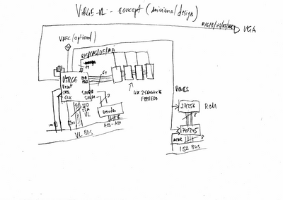

My concept (minimalizied design), need only two TTL (74F245 and 74F260 ), but i would make others with address decoder.

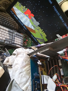

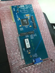

I am back with first life sign of Virge...ähm...Trio64V+ VLB. I am waiting of Virge donate. ( one is in transit to me )
Trio64V+ is damn fast, faster than Trio64 VLB.
Of coruse, i use PCI Card-ROM from a trio64V+ with 45ns EDO RAM.
Card has 50ns EDO DRAM, DRAM-donate was a turkish made SAT-TV Receiver *lol*
I haven't check him with Windows 9x. But i feel good.
The attachment trio64V+VL.jpg is no longer available
Beautiful card, isn't ? 😀
The attachment lifesign.jpg is no longer available
DOSbench.
Greetings
matt
