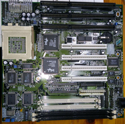

I have this motherboard and after a few years (≃20) I wanted to find out what happened to my motherboard.
After a BIOS update to the last version the motherboard stopped POSTing after pressing the power button, I have to press the reset button to actually have it POST.
From that point on it works perfectly without issues and has no random freezes/reboots/instabilities.
Any ideas?

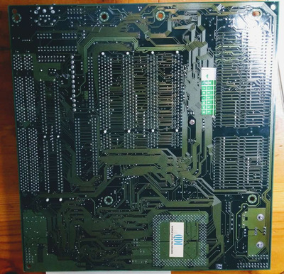

Reply 1 of 12, by Nexxen
Motherboard pictures.

Reply 2 of 12, by Horun
Do you know if the flasher updated the BIOS Boot Block (usually they are not updated BUT some BIOS updates require it) ? Did you load BIOS "Setup Defaults" after flashing ?
Which BIOS did you flash it too ? You probably should put a battery in it....

Reply 5 of 12, by Deksor
I have uploaded your photos here : http://www.win3x.org/uh19/motherboard/show/6048
Moreover, we have uploaded all the bioses we could find for your board 😀

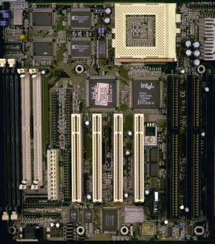

Reply 10 of 12, by PARKE
PC100 SDRAM should theoretically be backwards compatible but there was a lot of variation in quality in the early days.
Maybe it is a BIOS issue ? I used to have this exact board in the past and as far as I remember (not 100% sure though) it worked with both pc66 and pc100 sticks.

Reply 11 of 12, by Nexxen
PARKE wrote on 2021-02-24, 12:37:
Maybe it is a BIOS issue ? I used to have this exact board in the past and as far as I remember (not 100% sure though) it worked with both pc66 and pc100 sticks.QDI.JPG
This w/e I'm going to try out all my pc-100 sticks and see what works.
Try different fsb options.
Pity the bios chip is soldered, will have to reflash by hand - TL866 is spoiling me 😀
