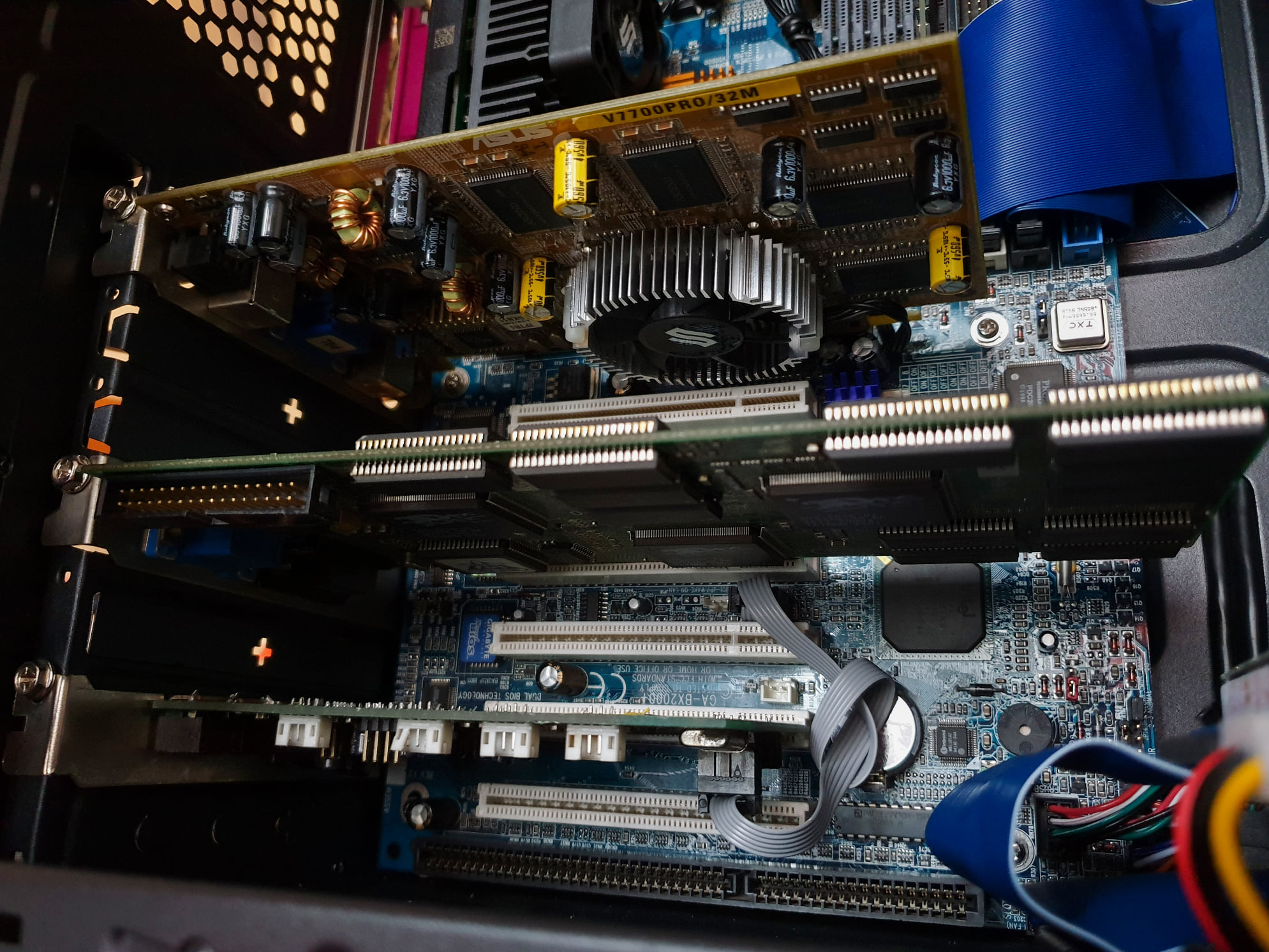

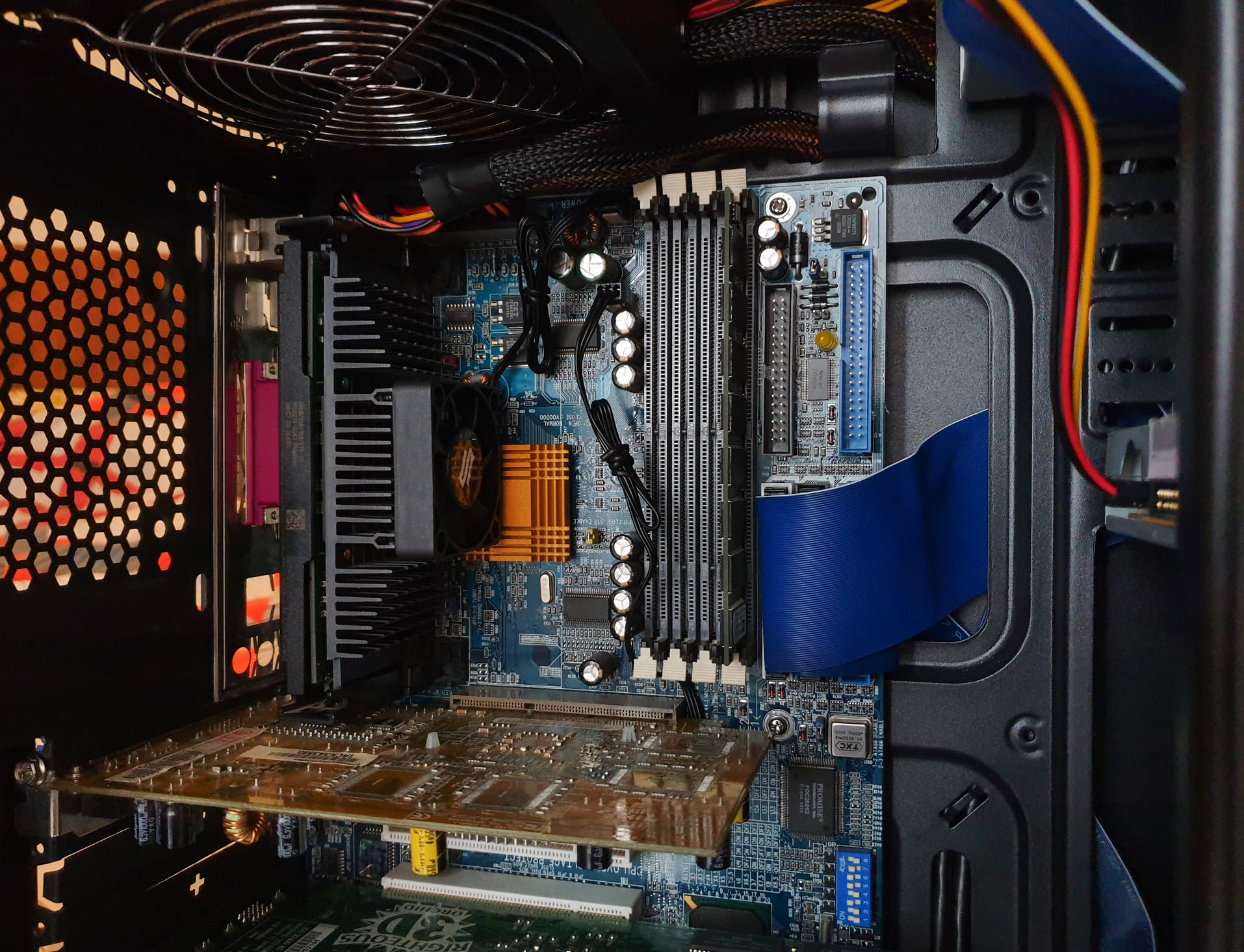

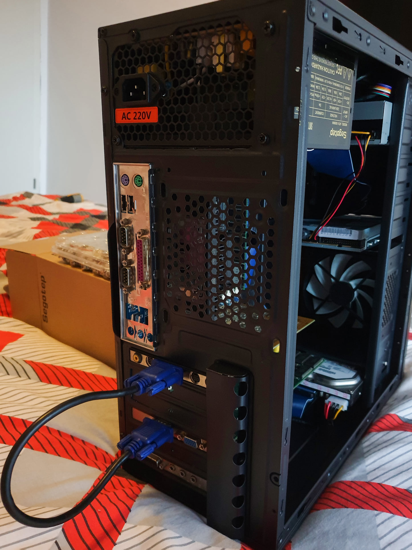

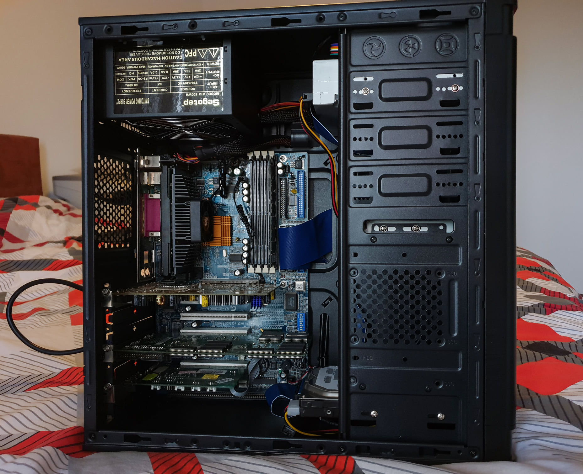

Finally, here's two pics (still in unfinished state):
- I still have the GeForce 2 MX installed in the case (will be replaced with the GeForce 2 GTS soon)
- Need to also install the DVD-RW
- Need to add a few 120mm fans... because why not? Maybe I'll go crazy with some RGB fans 😁
- Need to decide which sound cards to go with. I'll probably go with a SB Live 5.1 + an ISA card (haven't decided which one yet)
- Yes, those front USB 3.0 connectors are working 😁

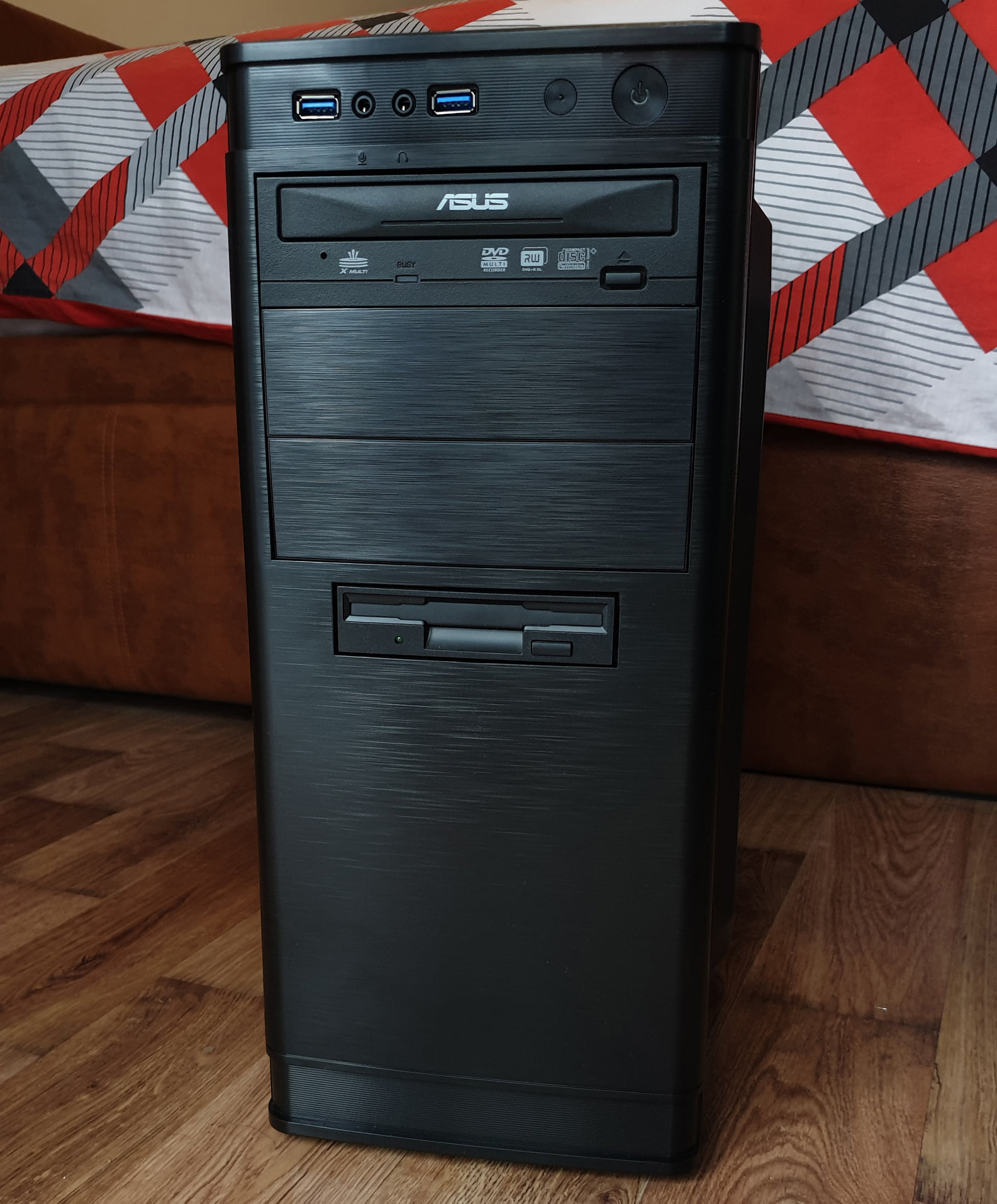

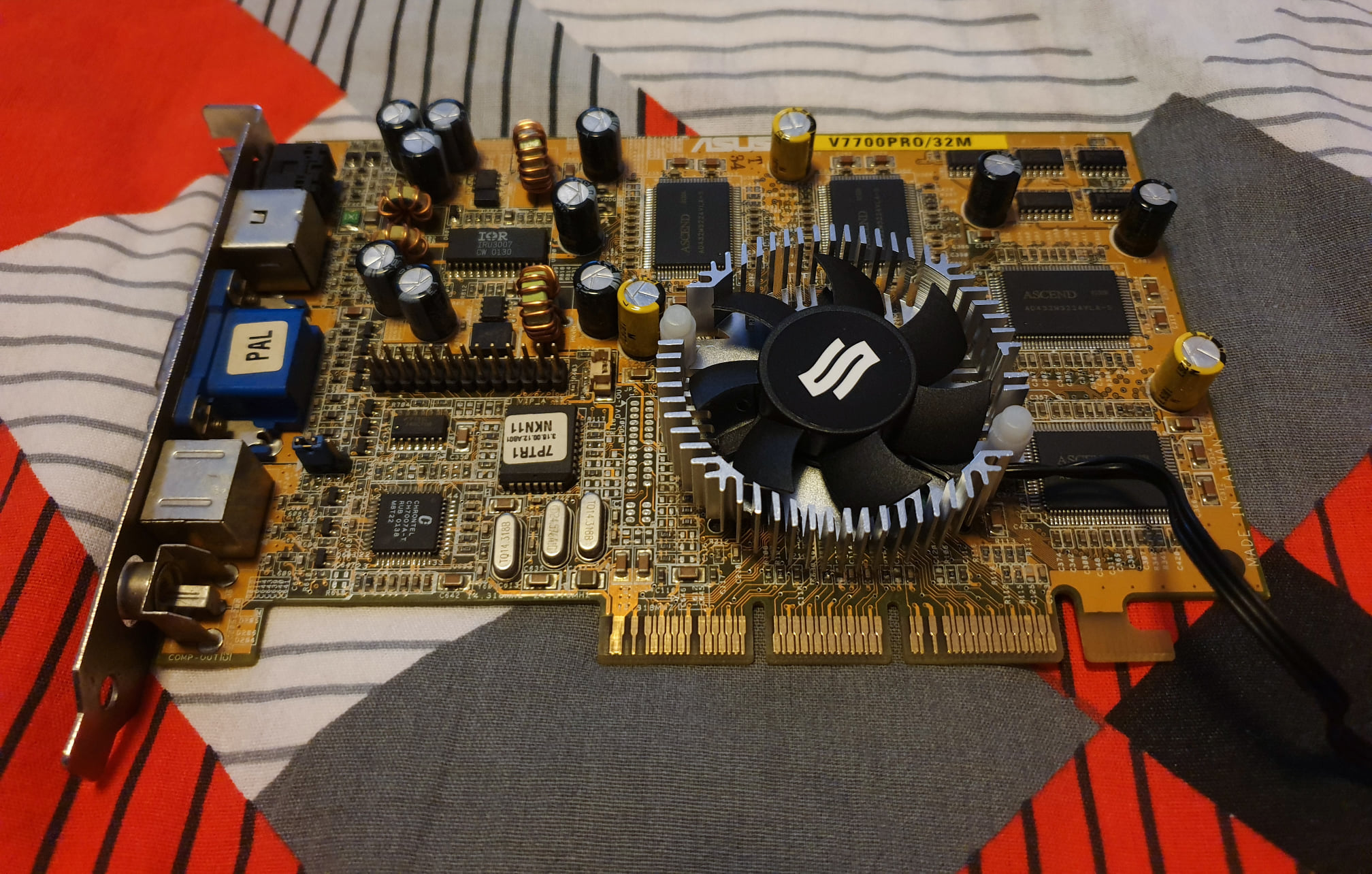

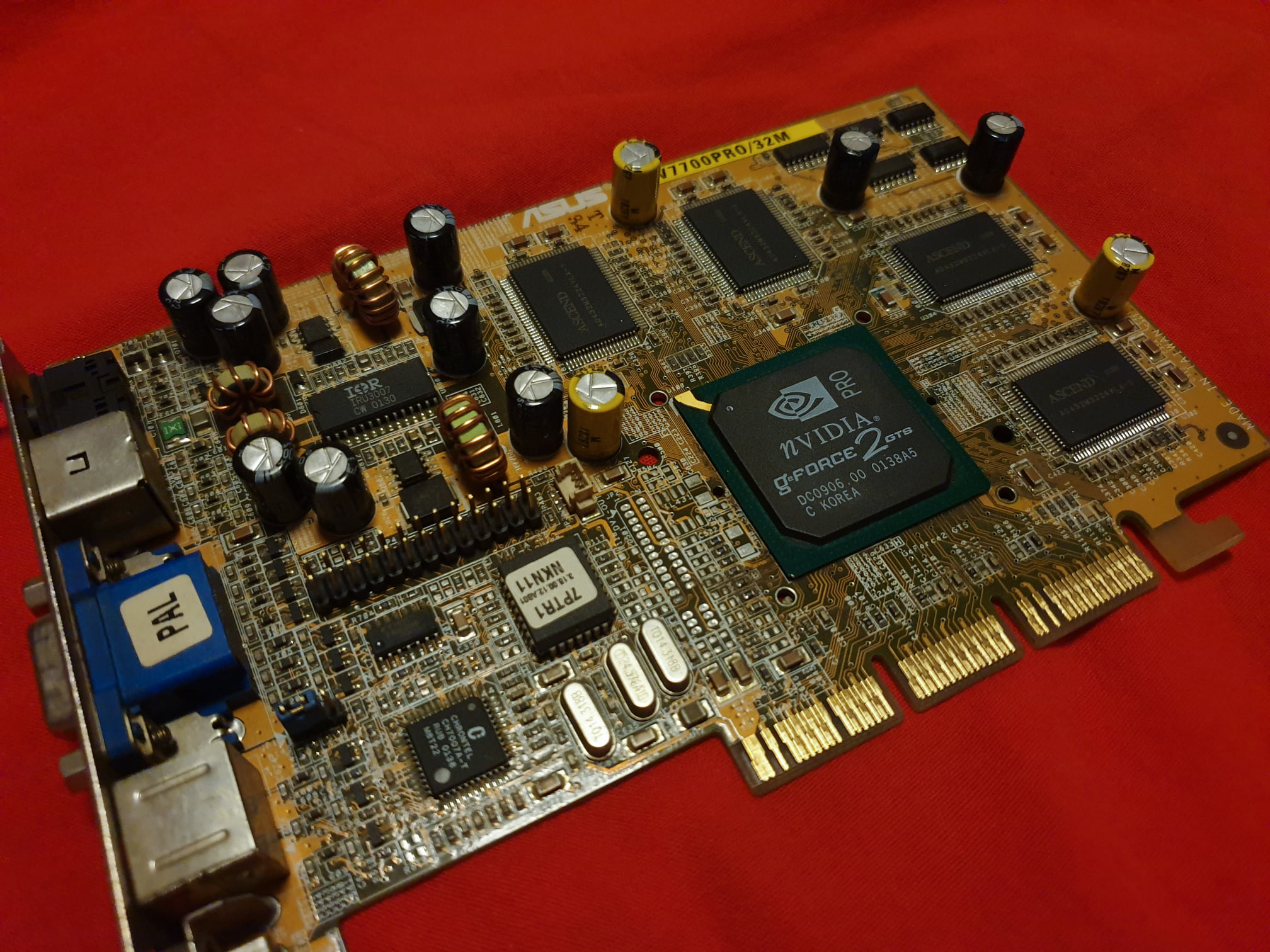

Reply 4 of 14, by bloodem
The Slot A build now has a brother (with an identical case): yet another Slot 1 PC 😀
Fun fact: through a series of unforeseen events, my wife ended up building 99% of this PC (and this is actually the first PC she ever built entirely by herself) - she even did basic wire management (which... looks better than mine) 😁.
The only thing I did was to mod the USB front panel connector, to make it compatible with the MB connector.
Yep, it's official... 2020 is weird.
Thank you to @aaronkatrini for the GeForce 2 Pro 😀

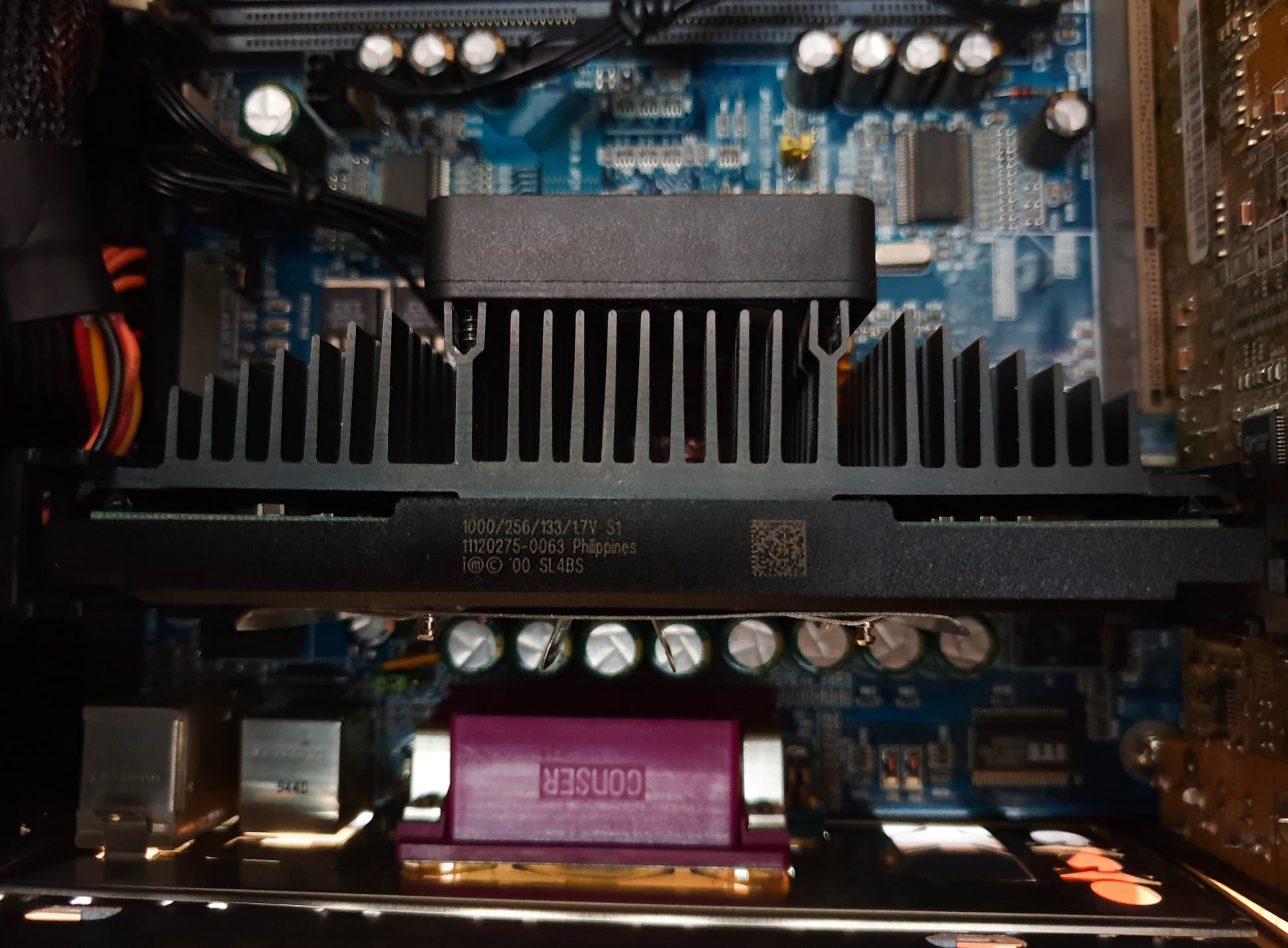

THE SPECS:
CPU: Intel Pentium 3 Coppermine 1 GHz FSB133
Motherboard: Gigabyte GA-BX2000+
RAM: 512 MB PC133 @ CL2
VGA 1: Asus V7700PRO/32M (nVIDIA GeForce 2 Pro 32 MB) + custom cooler

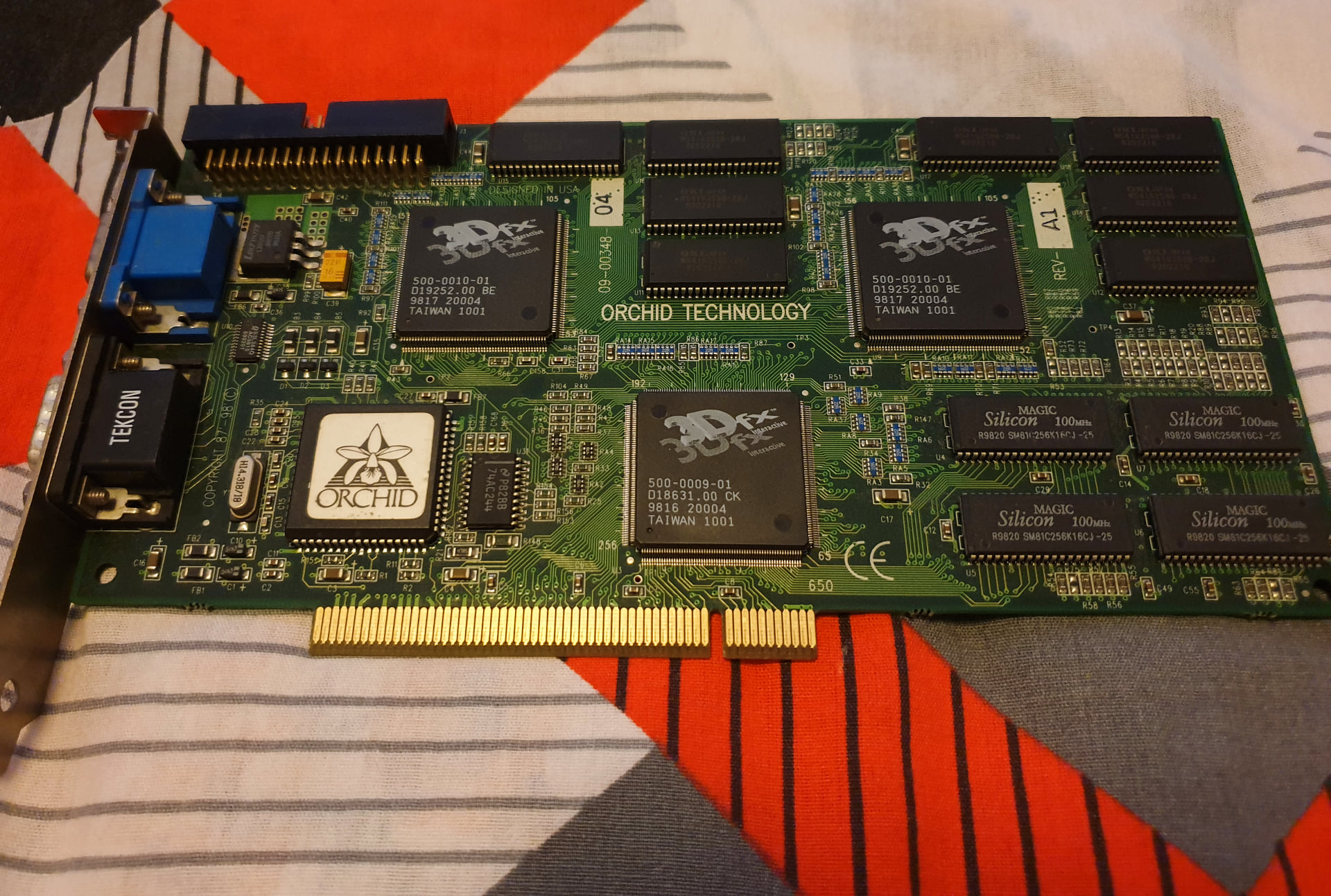

VGA 2: Righteous Orchid 3D II (3dfx Voodoo 2 12 MB)

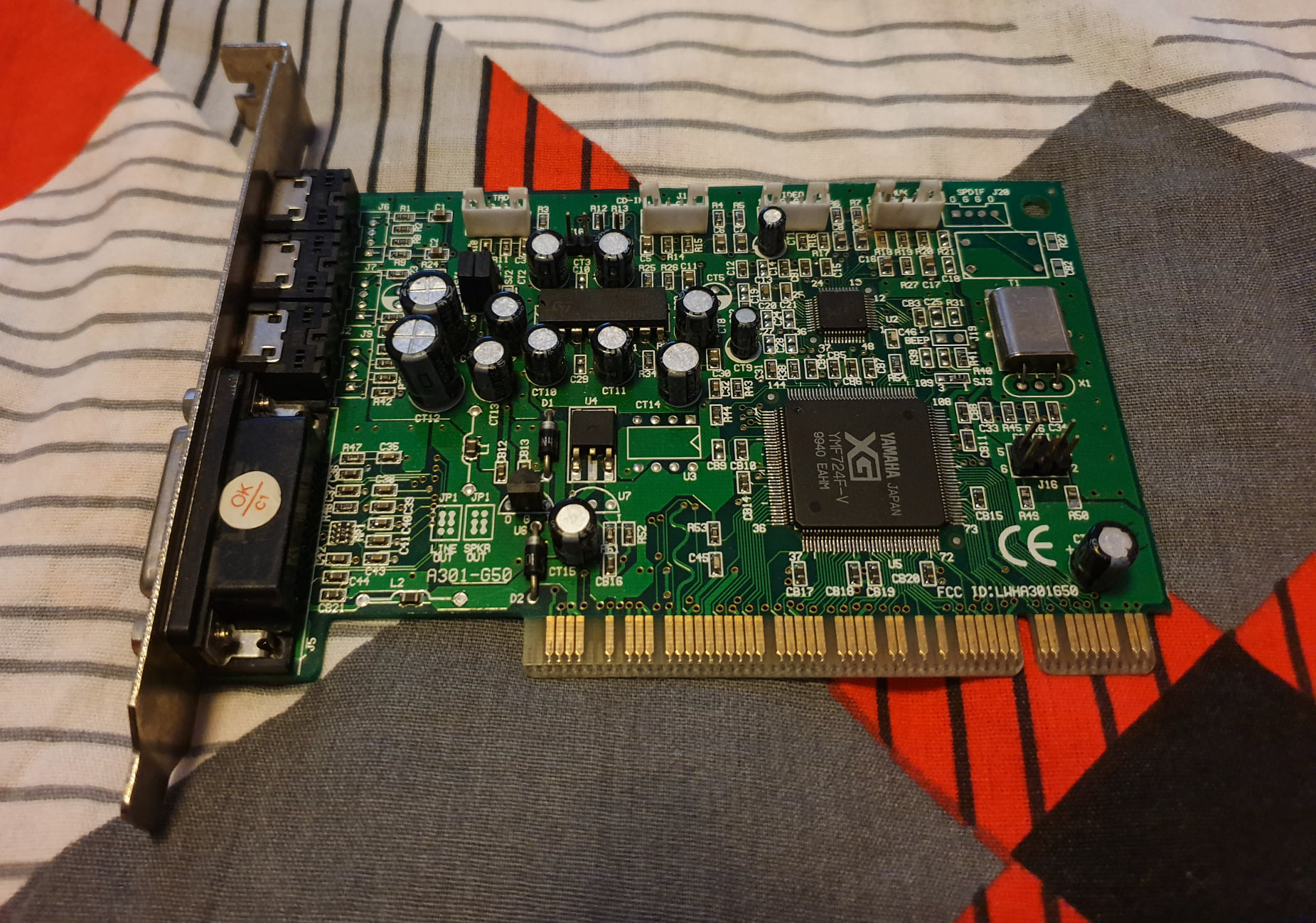

SOUND: Yamaha YMF724F-V + SB-Link cable (one of my favorite sound cards, somehow I always end up using it for most Win98 builds where DOS is also an option)
HDD: Hitachi 82 GB
OS: Windows 98 SE
Some pics:
Yeah, the YMF7x4 cards are incredibly versatile. No other PCI sound card can provide the same feature set, without being paired with something else.
On that note, I recently replaced my generic YMF724 with a Guillemot Maxi Sound Fortissimo which uses higher quality components and also has Digital Out (TOSLINK). It's amazing how much sound clarity one can get out of DOS games using that.

That card does look very nice, but it seems that it's missing a SBLink header, which is too bad (then again, it can be used on motherboards that don't have a SBLink connector anyway).
Current PC: Ryzen 7 5800X3D
Backup PC: Core i7 7700k
Reply 10 of 14, by Joseph_Joestar
bloodem wrote on 2021-03-23, 11:35:
It has one, but it's not clearly labeled as such.
The JP6 in the bottom right corner is actually SB-Link. I've tested it on my Abit ZM6 and it works just fine. Kinda strange that they didn't label it properly as someone might think that it's a speaker/line out jumper instead.
Reply 11 of 14, by bloodem
Joseph_Joestar wrote on 2021-03-23, 12:04:
Ha, that's exactly what I thought! 😁

Thanks to the wonderful people on this forum, we now have easy access to Athlon Golden Finger devices, so naturally I just had to revisit my Slot A build 😀
My Athlon "Pluto" Slot A 750 MHz was actually an 800 MHz part under the hood. Furthermore, it turns out that it's a golden sample - it overclocks LIKE CRAZY.
One of the first things I tried was to set the multiplier to 9, while also keeping the voltage at 1.6V. I was sure that the PC would refuse to POST, but not only did it POST, it perfectly booted Windows.
At first I thought that maybe the voltage was higher than I thought, or that the multiplier was not set correctly... but no. My motherboard has voltage monitoring and it was reporting 1.62V for the VCORE, and the frequency was in fact 900 MHz. Ran a bunch of benchmarks, no issues... however it did crash after 15 minutes of Prime 95 (small FFTs). Not a problem! Quickly increased the voltage to 1.65V and the system was rock solid after that. Amazing! Considering the fact that even original 900 MHz and 1 GHz Orion CPUs come with a default voltage of 1.8V, my CPU is definitely a top performer.
Of course, I also had to try 1 GHz and it did work, however the CPU needed 1.75V to be Prime95 stable. This is still below the default voltage for 1 GHz parts, but temperatures are a bit too high for my liking - apparently 45 degrees C idle/50 degrees C load as shown by the motherboard temp monitoring, but using a thermocouple on the back of the CPU, it turns out that actual temperatures are far higher: 63 degrees C. This means that the CPU die is even hotter, and let's not forget the cache chips which are most likely even more sensitive to heat.
So after a lot of testing, I finally settled for FSB110 x 8.5 multi @ 1.65V (935MHz). The speed is very similar to 1 GHz (FSB 100), but the CPU is a lot cooler. The cache runs at 2/5 divider which results in a whooping 374 MHz (higher than any Athlon in its original state).
Of course, I also added a lot of coolers (2 x 50 mm fans on the CPU, 1 x 120mm intake fan in front of the case, 1 x 120mm intake fan on the case side panel directly above the CPU, 1 x 120mm exhaust fan on the back of the case).
Some benchmarks with the 935 MHz overclock (they can be compared to the 750 MHz benchmarks in the first post, it's the same PC):

I replaced the original CPU die thermal paste/cache thermal pads with Arctic MX-2 and Thermal Grizzly minus pad 8 thermal pads.
As can be seen in the first photo, the original cache thermal pads in particular were a joke, one of them was barely touching the cache chip (from what I read on Anandtech, this sloppiness was quite common at the time, especially for Athlons up to 900 MHz).
After doing so, temperatures at 1 GHz / 1.75V dropped significantly (55C during Prime95, as reported by my thermocouple).
Unfortunately, even though the CPU is Prime95 stable at 1 GHz, it's actually only 99% stable during normal use (there are a few random BSODs per day). Bumping the voltage even further does not help in any way.
So, my assumption is that it's related to the external cache chips. At 1 GHz (with the CPU's default cache divider: 2/5), the cache is running at 400 MHz, which is definitely pushing its limits. So I need to find a way to force a 1/3 cache divider on my motherboard.
Unfortunately I have yet to find a solution to the cache divider problem. I tried all possible software solutions (those created by H.Oda! 20+ years ago), tried to modify the Gigabyte 7IXE BIOS file with the FixCache utility, nothing worked... The divider is stuck at 2/5. Apparently there was another utility (WCPUA2B) created by H.Oda, and this one had been successfully tested with the F3 BIOS revision of the GA-7IXE. However, I was unable to find this utility anywhere 🙁
If anybody has any suggestions or a miracle workaround let me know 😀
UPDATE: I had to give up on software solutions for the cache divider problem (they are definitely a waste of time / not very reliable). Instead, I just swapped a few resistors on the Athlon PCB and, lo and behold, the CPU is now PERFECTLY stable @ 1 GHz with 1.75V.
