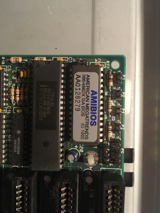

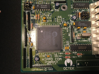

I am trying to build a 486 dos machine. The board I want to use is an Octec EP40085R12 Rev. 1.2. from 1993. It works so far, however, I would like to upgrade the CPU to an DX33 (SX25 at the moment). For that I would need to adjust the jumper settings and I dont have any information on how to do that.
Does anyone have the manual/jumper info for this specific board?
The board:

Great ! Could you post one more closeup picture of the motherboard ? the BIOS area where the front panel headers and the jumper next to the BIOS are a bit hard to read,
am going to try to make a "line-drawn" layout for the Octek Hippo COM.
Also if you could try NISSI and save your current BIOS and post it it will be of great help to others. Thanks !

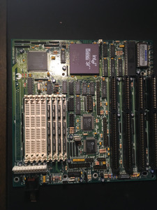

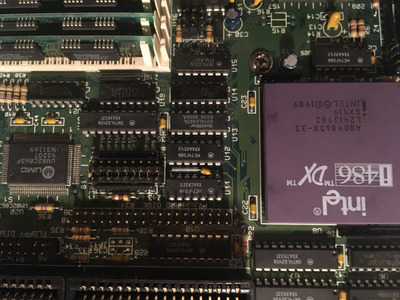

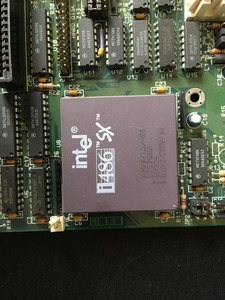

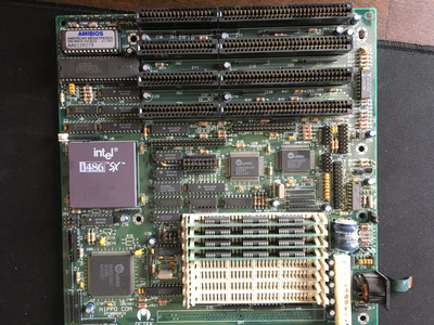

I already installed the board in a case, so here is a mixture of pictures I took before without paying attention to specific details and some images I could take after opening the case (with the board installed). I hope, Horum, that everything you need is visible...

Reply 7 of 8, by Horun
pelichanic wrote on 2020-10-20, 20:23:
Yes that is great ! Thanks !
Download the Getrom.zip file Deksor attached. You want to unzip the files on bootable floppy disk that does not load memory managers, then run ROMSAVAT.exe and it will write the bios file to the floppy....
