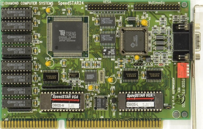

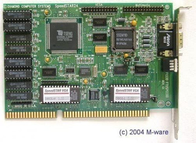

Warning: there are at least three variants of SpeedSTAR24, with different RAMDAC chips:
- Music TR9C1710, 8-bpp
- Sierra SC11483, 15-bpp
- some 24-bpp chip, can't find exact info, but the manual clearly states True Color support, and there's appropriate option in Windows 3.1 drivers package
And different RAMDACs probably need different BIOSes.

Reply 16 of 57, by Grzyb
So it works as expected.
Standard VGA supports up to 8-bpp, and all RAMDACs are compatible here.
Higher color depths, however, are RAMDAC-specific.
From what I've found, SpeedSTAR24 cards were available with three different RAMDACs: the mentioned earlier 8-bpp Music, 15-bpp Sierra, and 24-bpp Diamond SS2410.
No AT&T - so you probably won't find a BIOS with AT&T support.
But you can try some UniVBE/SDD - it seems to detect many RAMDACs, so it may provide working VBE modes with >8-bpp.

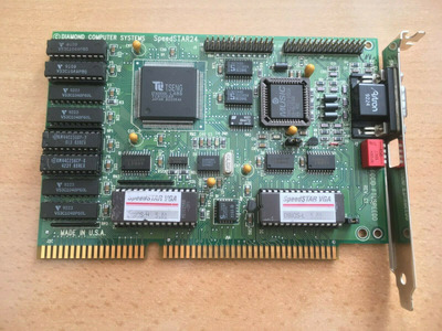

Reply 18 of 57, by Baoran
Card with Bios 4.23 looks different than cards with 5.01 and 6.01 bios. Components are in different locations and multimedia connector is missing so I am not sure I should try 6.01 bios with that. The cards with 5.01 and 6.01 bios look alike other than the bios chips.
