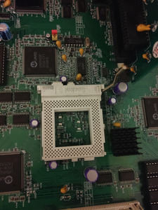

I'd like to toss a P133 or 166 in the machine but unfortunately can't seem to get it running at full speed. Only 100mhz max.

Does anyone have a visual on that?I have some copper wire, so do I just strip it a bit and stick that in the respective holes on the socket before putting in the CPU? Iv never done this before
Here's a picture of the socket on the board in-question:

Here's the pinout from the datasheet flipped as if you are looking into the socket to match your picture.
Use 2 small strands of copper (I usually pull them from a piece of mains wire) bent in a U shape and dropped in the right holes to ground BF0 and BF1 for 2.5x (P166). As there's no convenient VSS near BF0 link it to BF1 since it' going to be grounded anyway.
For a P133 it's a bit more annoying as you have to ground only BF0 which has no VSSs nearby. As your quote says if it's a later production unit it will also run at 166 likely.
