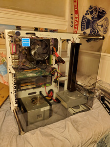

Getting the CD Rom to mount to case required me to dive pretty deep into my parts bin.
Had to order a cable extension for the CPU power. I'm hoping this board has some IDE legacy mode so I can install Win98SE directly to an SSD.

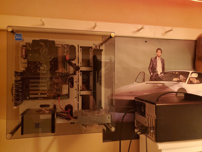

Reply 4 of 14, by RedCharles
Mounted it using a small TV mount. Still waiting on parts.

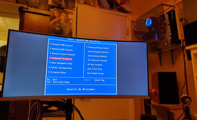

I'm look at Hammer Fid Control in Phoenix bios. After looking at Phil's video, it looks like I need to trim that down to 800 and lower the voltage too.
There's no watch battery on this board. Blows my mind. HD audio header was directly below the I/O and had two jumpers on it. Weird. Newer Ryzen CPU fans fit on old boards, which is awesome. There's little blinking lights on the PCI slots and the north bridge cooler. Very 2005 RGB. There really are a lot of ports on this ECS KV2 extreme motherboard.
Been trying to boot from a sata cd drive. I don't think the motherboard sees it. I tried another sata cd drive, but it doesn't see that either.
It sees an ide laptop drive that has a sata converter on it. Which makes me wonder why it's skipping the cd rom during the boot sequence.

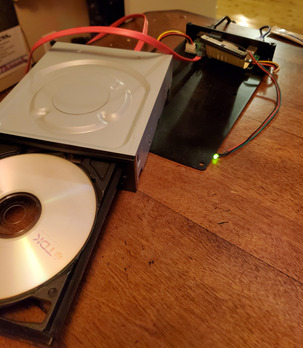

Reply 8 of 14, by RedCharles
So I remembered I had this makeshift drive sled. It works. Slowly.
I got it to boot from this. Drive sounds terrible.
Still dont know why it doesn't see either sata cd drive in bios.
Also, my bios labeled the ide laptop drive as a SCSI drive.
