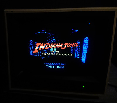

The result is, it seems to accept analogue signals but only understands 16 colours as far as I can tell without a mod.
It's damn sharp!
488.11 KiB
138 views
(Quick and dirty test with GOG Indiana Jones (so guessing the VGA version) on WIn 7 @ 256 colours compat mode means it's missing quite a lot of detail)
I will have to hook up a retro machine to test the 16 colour theory with some EGA games another day.

Think I know whats happening.
It probably works by normalizing each RGB analogue voltage before the DAC in the monitor so: Analogue <0.45v = Digital 0v (Off) Analogue >0.45v = Digital 5v (On)
Pretty neat, need to test if it can just do 8 colours (2 steps) or 16 colours (3 steps - simulating RGBI).
Hoping a Vogoner can tell me if this is normal for CGA/EGA TTL monitors or some JDM circuit wizardry 😀
