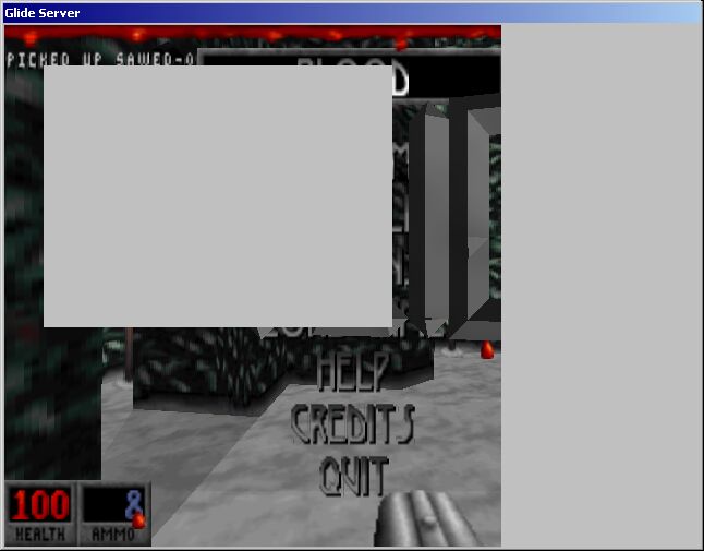

Think I've sussed the graphics anomalies. Here are a couple of files. Glidos.exe is a new version of Glidos with some hardwired hacks specifically for Blood. The hacks probably wont show any noticable effects in other games. Glide2x.ovl is a new Glide driver for Glidos; the only change there is it gives fuller support for the mouse in Blood (buttons aswell as movement).
The 3dfx version of Blood does some strange things. It isn't surprising that sometimes the graphics were messed up. Not only does it build the whole seen from long thin triangles, but also it doesn't bother to set the texture coordinates on one of the apexes.
The new version of Glidos turns these triangles into rectangles, and sets the missing texture coordinates. This also means you can set Glidos to higher resoltuions without problem, although the advantages of doing so aren't as apparent as in most games.

NOOOOOOOO! DOESN'T WORK! (But at least it looks nice and sharp for the .5 seconds it runs 😉)
oh, by the way, WHY is the GliDOS logo still there? I even generated my OWN CODES and ... gah. Death.
Still gives the same stupid crappy window with grey boxes on it. Arrgh. Maybe updating my graphics drivers will help. I meant to do that earlier to fix SDL problems. I'm just lazy like that.
Pretty sure the grey box is where a window has closed uncovering an area after the program has died (so the area doesn't get rerendered). Wonder what window it was; looks the size of the VDMSound hint box, but I'd very much doubt you had that enabled.
