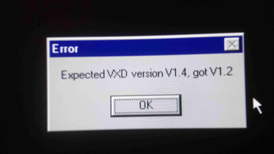

For starter, i used only Windows 3Dfx drivers, driver is always installed fine, but its not working. Error is usually something about bad pixel format or bad VXD version - 1.2 expected 1.4 or something like that.
- its the same with older 3Dfx drivers and its in-build Diamond driver.

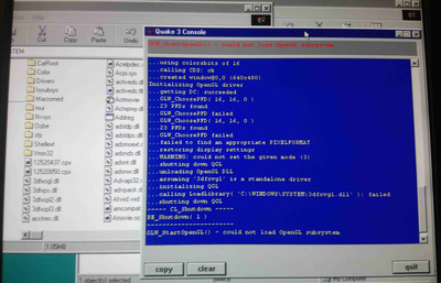

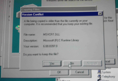

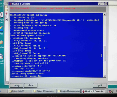

Reply 1 of 2, by ruthan
Here are some pictures..
You can see, that Quake 3 demo is asking for some not existing file, also during installation im asked to rewrite some MSVC*.dll, im always choosing keep newer version could it be problem? But if im not wrong that is exactly file, which is broken after Diamond drivers install, because they dont ask and probably rewrite file with some old version..

Reply 2 of 2, by ruthan
Ok, i won, this helped:
https://groups.google.com/g/3dfx.games.glquak … /m/oyYKd90CrA8J // Because Google groups iis using very awfull interface for messages, you have to click on message to see whole message..
Problem is (was):
Windows/System directory /FXMEMMAP.VXD
great is that you can test it without restarts etc.. just replace it on the fly.. in my case, im now using older 3Dfx 1998/11 drivers.. but with FXMEMMAP.VXD from Iceman package and its working.
I dunno what this FXMEMMAP.VXD is doing, but maybe is problem that im using whole full 768 MB of RAM on my K6-II machine, bu if im not wrong except some fix for safe mode, up to 1 GB (1120 or something like that for more you new rLows magic), it should be safe.. And i also dunno how much bad thing is mix this file from different driver version.
GLQuake, Hexen 2 , Quake 2 demos are fine, only Quake 3 demo is not working, but i guess that is another problem..
