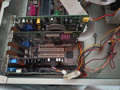

Hello,
I would like to setup 3x sound cards based in the following specs:
Mobo: ASUS P3B-F v1.04 Intel 440BX motherboard Slot 1 [2x ISA slot variant]
CPU: PENTIUM III 500Mhz SL37D
Graphics AGP: MEDION MSI GeFORCE4 TI 4200 128MB DDR SDRAM AGP
Graphics PCI: Voodoo 3 2000 PCI
Soundcard PCI: Yamaha YMF724-V AC-XG
Soundcard ISA: Creative Labs Sound Blaster AWE64 value CT4520.
Case: InWin H500 desktop case
Current OS = Win98SE, but intend to use MS-DOS later on]
Currently both sound card have been installed, and since I like the sounds of the Yamaha I decided to set it as the default, hence had to fiddle with IRQ settings and changed IRQ, DMA etc with those of the Creative 64.
    1.43 MiB
    1561 views

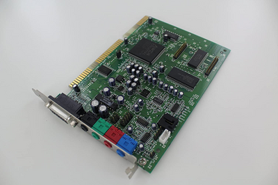

    222 KiB
    1561 views

1) You need a Raspberry Pi CM4 "Compute Module".
2) Can't answer because of 3)
3) Neither of the cards you are using have a wavetable header. The WP32 MCCAKE is not a stand alone internal device. It has to plug into a sound card that has a wavetable header. So if you want to do this you need a 3rd sound card for it. Otherwise replace one of the two you have.
But honestly I do not see any reason to do this. it's completely overkill and is going to be a resource and compatibility nightmare.
If you are intent on using those 2 cards, then it would be better to use the MT32L which is basically the external version of the WP32 McCake
Otherwise I would go for the MK8330 modern reproduction card, for the most overall use cases and toss out those 2 cards. http://www.pcmidi.eu/mk8330.html

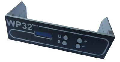

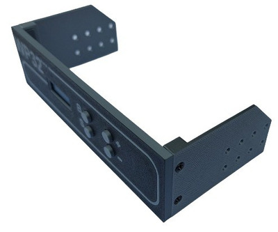

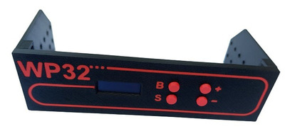

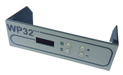

Reply 414 of 424, by dreamblaster
Hi yes both MP32L and Mccake can be used inside a PC.
MP32L has a footprint for pin headers on the pcb, so you can also add a cable to a panel.
By the way, I had new panels printed some time ago, now updating the pictures !
