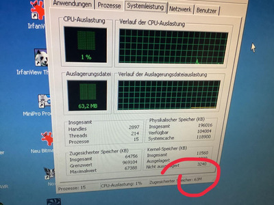

Reply 12 of 36, by matze79
Huch it depends hardly on the programs you run.
If you optimize it will run on less then 256Mb and it will run snappy
This is XP SP3 Professional

Reply 13 of 36, by cyclone3d
matze79 wrote on 2020-11-20, 06:22:
Huch it depends hardly on the programs you run. If you optimize it will run on less then 256Mb and it will run snappy […]
So what exactly can you run smoothly on XP with only 256MB RAM?

Reply 14 of 36, by Baoran
cyclone3d wrote on 2020-11-20, 06:57:
I can get it up to 512MB with 4 128MB sticks, but unfortunately I don't own 256MB sticks to get to 1GB
Reply 16 of 36, by cyclone3d
Isn't dual pentium pro a bit old for normal XP stuff though? 512MB in XP for period correct software was always a horrid experience for office type computers and for gaming. Tons of swapping going on. Upgrade to 1GB and all that went away for the most part. Later XP games and running a lot of applications at the same time was even better with more RAM.
Sure, there are special use cases, but for normal XP era hardware and software 512MB plain sucked.
