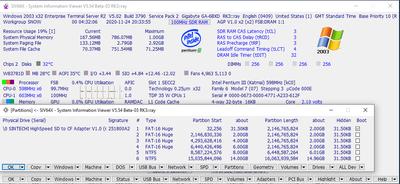

Reply 4 of 46, by red-ray
darry wrote on 2020-11-24, 20:12:
make sure that the first partition on the card is FAT32 or NTFS, otherwise you will almost certainly have issues. That first partition does not need to be big or usable by DOS,or even set to active . If the first partition is FAT12 or FAT16, all the FC1307 based adapters that I have tested will see the disk as blank on power up .
My controller uses an FC1307A and having the first partition as FAT-16 is fine, maybe this is down to it being the A
I have Windows 98SE installed on the first partition and WXP + W2003 on the NTFS partitions

Reply 6 of 46, by darry
red-ray wrote on 2020-11-24, 20:45:
My controller uses an FC1307A and having the first partition as FAT-16 is fine, maybe this is down to it being the A […]
file.php?id=96945
That could definitely be the case. My FC1307A adapters identify as FC1307 in their BIOS . Another possibility is that there are multiple BIOS versions circulating for these and not all of them have the issue .
If anybody can post a BIOS dump from an FC1307 or FC1307A that does not have an issue with a FAT16 or FAT32 partition being first on the disk, it might help explain why some people, like jmarsh and myself, have the issue, but others do not .
EDIT: Are those all partitions on an MBR disk or are some of them volumes in an extended partition ?

Reply 9 of 46, by darry
darry wrote on 2020-11-24, 23:05:
That could definitely be the case. My FC1307A adapters identify as FC1307 in their BIOS . Another possibility is that there are […]
file.php?id=96945
I have found a way to create a FAT16 partition in a way that the FC1307A likes . See Re: Using a vintage multi-track recorder as a mixer, namely the Roland VS-880EX - might apply to other Roland VS- units
There must be some slight difference between different partitioning/formatting tools that the FC1307A either likes or does not like . Offset from beginning of disk may be one of them or not .

Reply 19 of 46, by jmarsh
darry wrote on 2020-11-25, 00:33:
FAT16 has several possible partition table IDs:
04: FAT16, < 32MB
06: FAT16, >= 32MB
0E: FAT16, >= 32MB, using INT13 extensions (CHS beyond 1023/16/63 limits).
I would guess "FAT-16 Huge" would be the last one.
