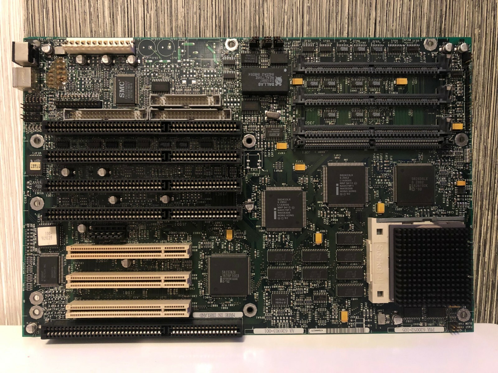

So I'm kinda new to building old computers. Anyway, what kind of case is compatible with this mobo? https://i.ebayimg.com/images/g/~doAAOSwbYFfujXp/s-l1600.jpg

Do the holes line up in an ATX case? Possibly an early case that understands AT layout?

Reply 3 of 17, by TheMobRules
Some later AT cases had 2 holes in the back, a larger one for the common 5-pin DIN keyboard connector and a smaller one below for the PS/2 mouse port. When using a motherboard like yours, the PS/2 keyboard connector should line up with the larger hole.
That motherboard is Batman's Revenge from Intel, I have one but with the large AT keyboard connector instead of the PS/2 ports.
Reply 4 of 17, by debs3759
If I remember, I'll check tomorrow whether the holes on mine line up in an ATX case, if nobody gives a definitive reply sooner. Mine only has the AT keyboard connector.

Reply 6 of 17, by debs3759
cyclone3d wrote on 2020-11-30, 04:32:
That board came from an oem system. That is a socket 5 board right?
It's socket 4. It's a Batman's Revenge that has had the AT keyboard replaced by a PS/2 connector and a PS/2 mouse connector added.
Probably also needs the Dallas chip replacing.

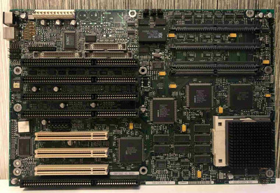

Reply 13 of 17, by debs3759
Cool. There are a few Zappa boards on eBay. Might have to buy one just for the name 😀
Reply 14 of 17, by Nitroraptor53
Wait, would this mobo support a Pentium 66? I only have 486 pc's right now so I want to build a Socket 4 Pentium 66.

Reply 15 of 17, by cyclone3d
Yes.
CPU options for socket 4 are Pentium 60, 66 and Pentium Overdrive 120/133.
Here is the manual:
http://ohwc.narod.ru/man-dat/mainboards/intel … ans_revenge.pdf

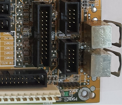

Reply 16 of 17, by computerguy08
My MS-5146 has the same PS/2 port layout as the Batman's Revenge board.
http://www.win3x.org/uh19/motherboard/show/3669
1.03 MiB
171 views
Looking at the holes nearby, it can accommodate a variety of configs, AT keyboard + PS/2 mouse, PS/2 keyboard + mouse w/large gap between the connectors
(maybe for an OEM case?) . It also has headers/pads for external keyboard and mouse ports. (JKB and JMS).
It does fit in a normal AT case, the screw holes match.
