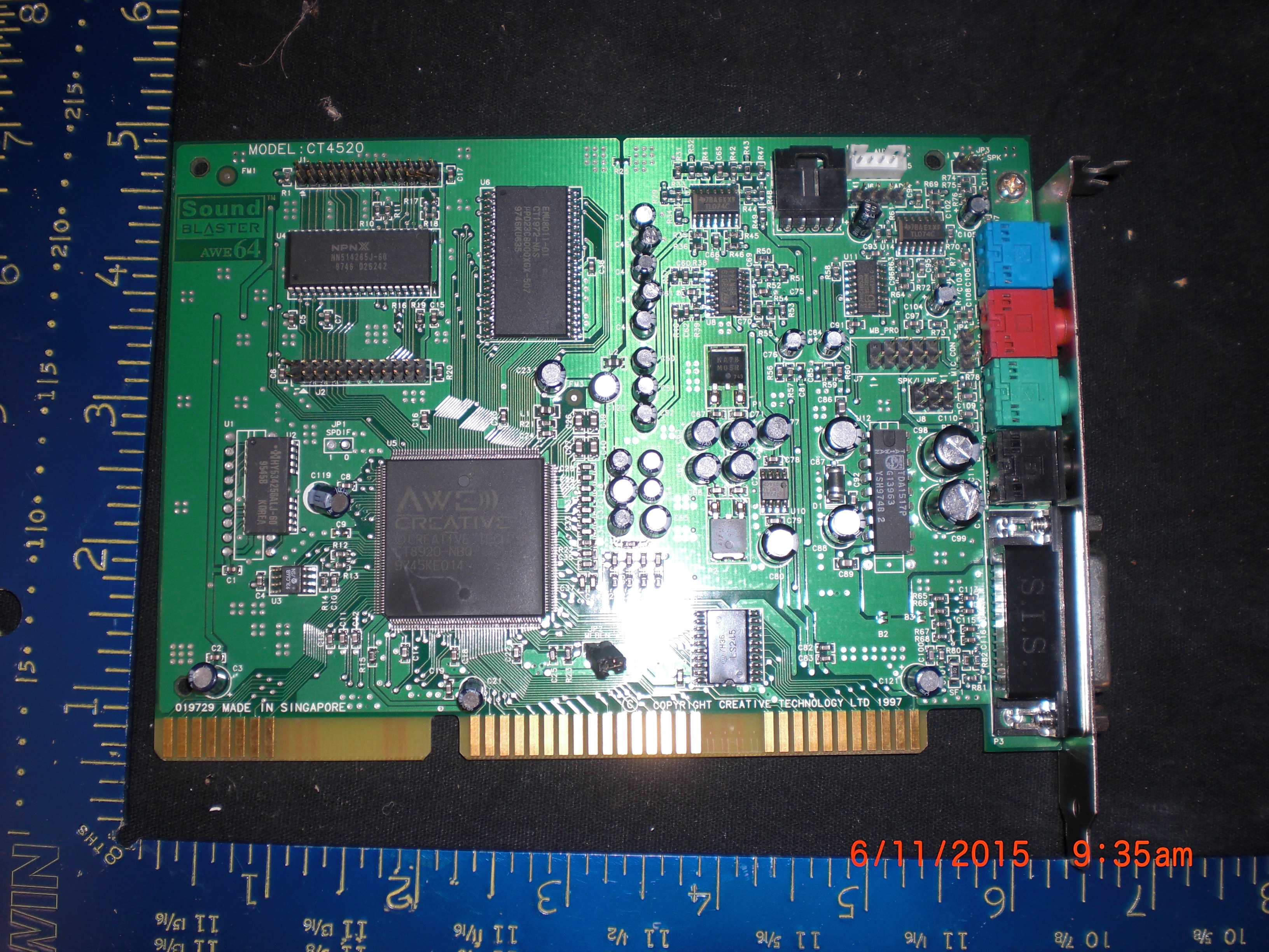

I have a vivid memory of seeing DOOM2 run on a friend's computer with AWE32 and the music being vastly better then my SB16
I have built a Pentium 200 retro PC with an AWE64 ISA Gold running Win98se and although I can hear a difference from the music on SB16 it's not the quantum leap I remember.
Do I need to do something specific with wavetables?
I tried loading GS and MT32 instead of GM but couldn't hear any difference.

Can you post a photo of the card?
All AWE64 Gold models should come with 4 MB of RAM.
Reply 6 of 8, by Dacobi
Joseph_Joestar wrote on 2021-01-04, 15:32:
Dacobi wrote on 2021-01-04, 15:24:
I tried loading both of them, but it
turns out my AWE64 only has 512kb of RAM so they wouldn't fit.
https://s3.amazonaws.com/gigabitps/CT4520.JPG
Don't know why I thought it was the Gold version.
Guess I'll have to buy a SIMMCONN expansion.
Reply 7 of 8, by Joseph_Joestar
Dacobi wrote on 2021-01-04, 15:47:
Yeah, the CT4520 is an AWE64 Value model.
In terms of soundfonts, very little can be done without expanding its memory.
